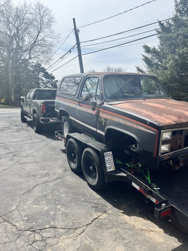

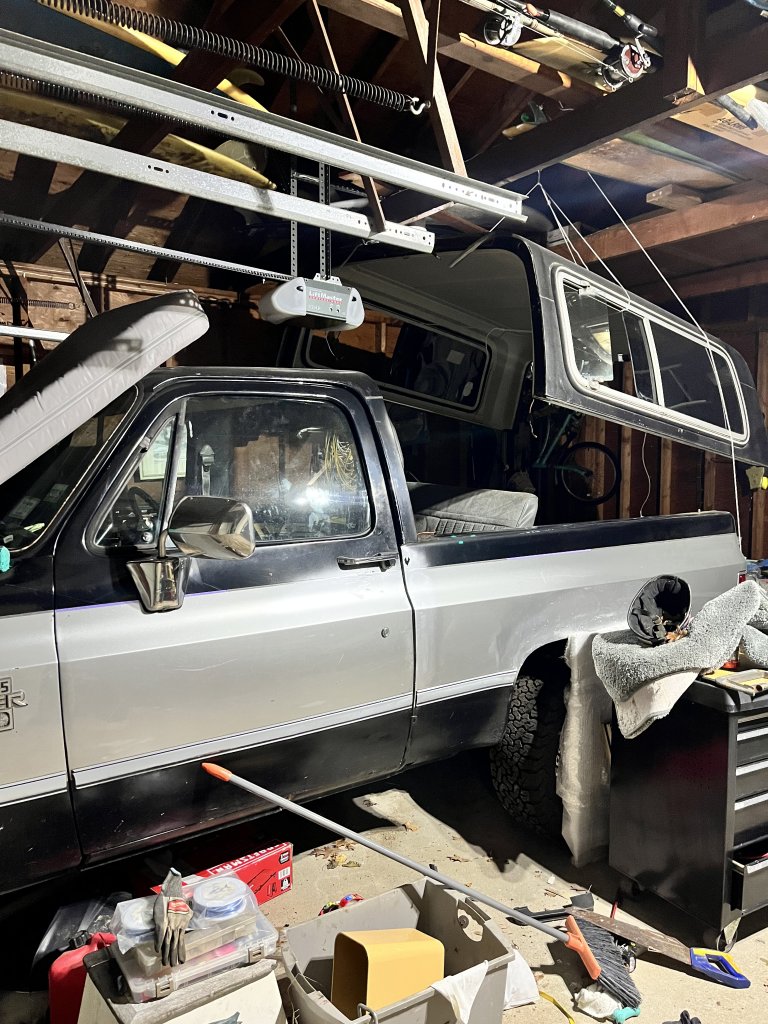

I’m doing a total body swap on a 84 blazer. Found a rot free body woth no motor. My body is pretty rotted but has a good drive train and clean frame. Any tricks I should look out for before I get started

Get some new body bushings & bolts. If you can do the swap without pulling the front clip it will be done in short time.

Avoid damaging the old body further and do not scrap it. It's probably valuable to someone with a completely shot body or a rolling frame.

Thx. Was going to scrap it but I’ll put it out there when I get it off frame

If you don’t have a lift, find someone that has access to one. A lift will make the swap so much easier.
That said, would it just be easier to move your suspension and drivetrain over?

I have a chain fault set up. And there has been a lot of welding on the frame I’m scraping
