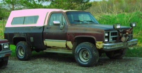

I run 33/12.50-15's on a K10 for near 40 years and they never hit/rubbed anything except the right side running board once in a while if bouncing through a turn. That was using GM 15x8 wheels. It would happen more when using 15x10's the short time I had the Jackman wheels on my 81 plow truck.

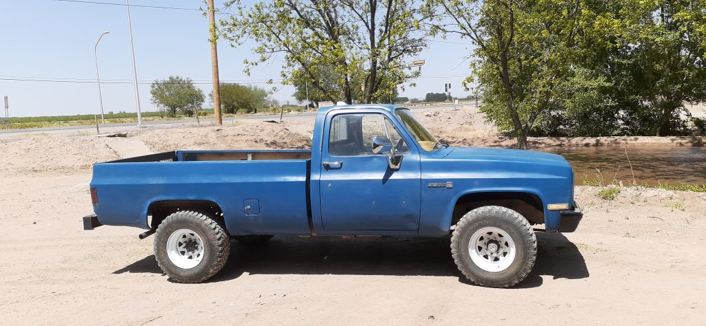

Probably will require a little clearance on the lower rear corners. You can cut the bottom of the fender behind the lip and fold it back and overlap it and you can hardly tell that its modified.

That's a great looking truck
Thank you! It's my "other" Square. But I am sure starting to like it. Its easier to get in and out of, and it has a Big Block in it!
