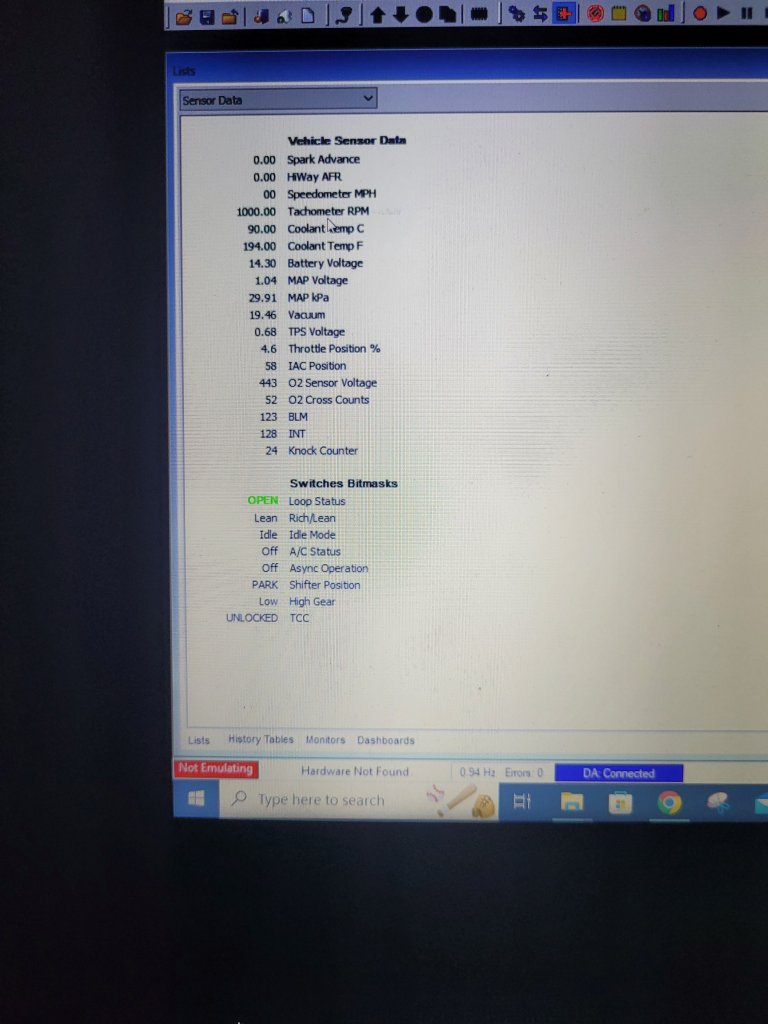

Between then and now I got a USB OBD1 scanner and started playing around with it.
With this plugged in I notice a few more things.
I am idling faster than I thought (1k RPM). This drops down slightly if I put the truck in gear.
After driving around some if I put it in park it will start idling at 2k RPM. This corrects itself (back to 1k) if I turn the truck off and right back on.
Knocks are being detected when I turn the truck on or off but not while it is running.
Screenshot from TunerProRT attached. This was mostly me learning how to use it.
SparkAdvance always reads 0
HiWay AFR always reads 0
It will go in to CLOSED loop. It just hadn't yet when I took the shot.
I don't know enough yet about what these should be reading to know if anything here could be telling the computer to advance this much or idle fast.

TPS voltage is a tad high, but likely not causing you any issues. You can slightly bend the tab to lower the voltage to a little closer to 0.5v at idle, but not critical.
IAC counts seem high for sitting at 195deg temp and warmed up. You may try a reset on it. Jumper A and B on the ALDL with a bent paperclip. Then turn key to "on" for 30 or 45 sec. This will force the IAC all the way closed. You should be able to hear the stepper motor clicking. Then turn the key to "off " and remove the paperclip. Then start it up and see how well it idles down.
IAC counts should be in the 5-35 range for a stock tune and idle ought to be in the 550rpm range.
If that doesn't help, you may pull the ECM out and see if it looks like somebody has put in a different PROM chip. It could be its not on the stock tune.
