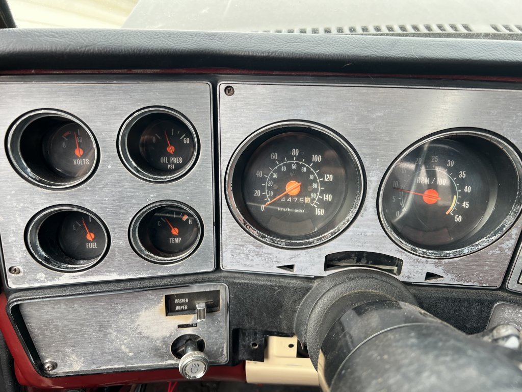

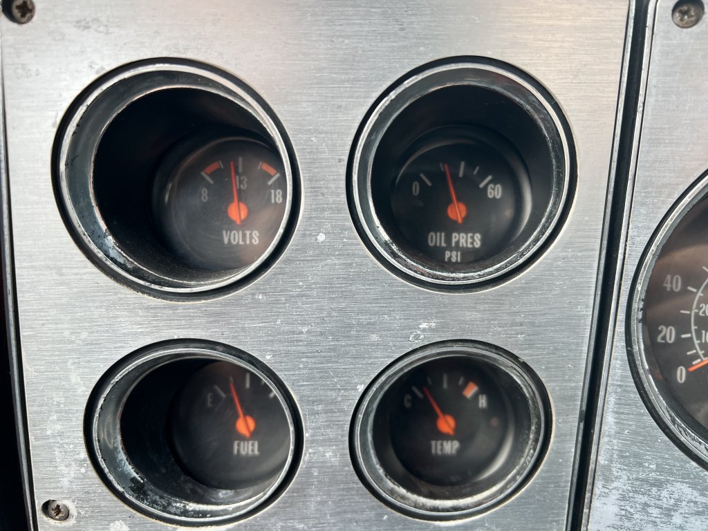

So I ordered a new circuit board off ebay installed it all the tach came to life. problem solved.
Here is a pic of all the factory gauges up and running. Took along time to chase everything down but it’s finally back to normal.
Only thing is I think I have the wrong temp sensor as this is fully warmed up 180 thermostat open. Only reading 1/8th of the way up the gauge.

Glad you got it sorted! Those temp sensors can be a PITA finding the right one. I went through a couple before I happened upon one from Autozone that read right- I have seen on here people posting the correct ohms for the years but can’t remember where. I’d look back through my Autozone orders for the part number but mine is an ‘81 so might not be right for your application.
