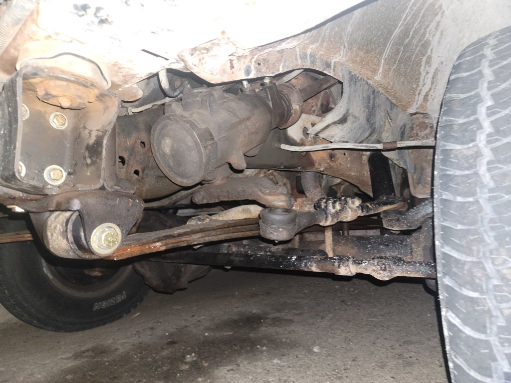

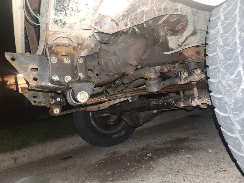

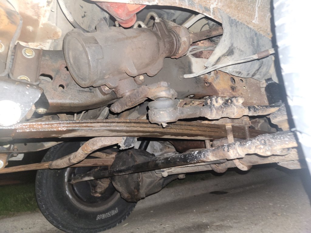

Just went and looked, took a couple of pictures. Sorry if they aren't very good it's dark now. Seems like the arm is relatively straight. Maybe slightly angled down?

It's supposed to be toed in not toed out. Toe out will make most cars super twitchy,it will quick steer no matter which way you turn. It is a racer trick though to get the car to turn in quicker.. Also not enough caster will make them super squirlley get your alignment right then post back of it still acts funny.
