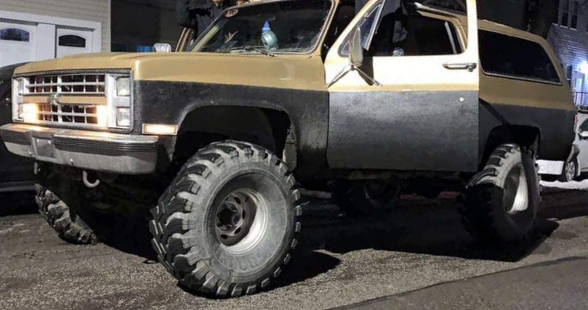

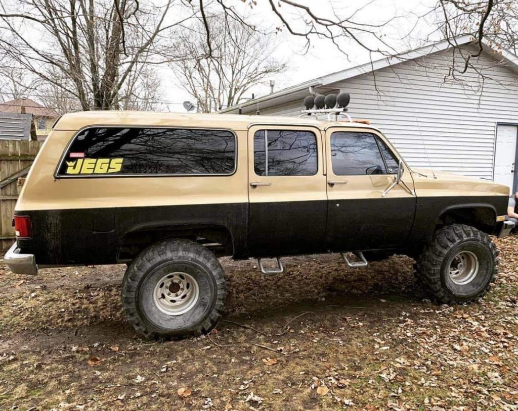

I plan on trimming them to have the same look as these photos. I don't plan on adding flares, the trimming would strictly be to have large tires

To have a stock look it wil take a lot of body work. I would at least fabricate a connection between the fender and fender well to add stability.
