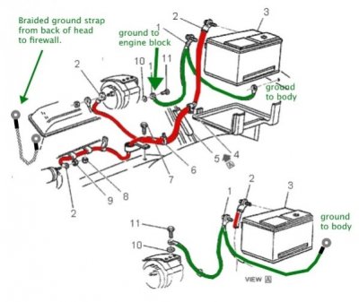

Ok you have 2 battery cables right ?
One is the positive cables and it go's from the positive side of the battery
to the starter
The other cables is the ground cable
it go's from the negative side of the battery to the engine block
it looks like it used to run to the alternator bracket but got cut
so where is the negative battery cable running to now

View A for the correct ground wire routing.

Quick test. Hook a jumper cable to the negative terminal and the other end to a bracket on the block somewhere. As mentioned above, you must have a large diameter cable from the battery terminal to the block somewhere, or else it will seek ground through something else. Something you don't want. I worked on a truck once that had a similar problem, and I figured it out when the manual choke cable turned bright red hot. The ground to the block was bad and it was grounding through the choke cable where it passed through the firewall.
The starter is the highest load on the electrical system, which is why the battery cables go directly to the starter solenoid relay and ground on the block.
