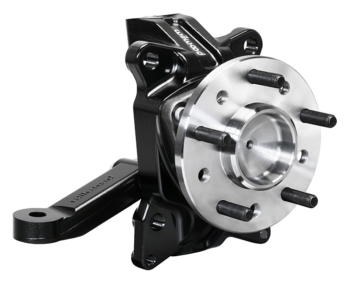

Go with drop spindles and coil over shocks. The modular spindles like suggested above are a nice feature.
I have the Wilwood pro forged modular. They are 2.5 drop spindles and the coil over's offer adjustment also.
The modular spindle eliminates brake pad knockback where the oem spindles can flex under hard cornering/braking.
