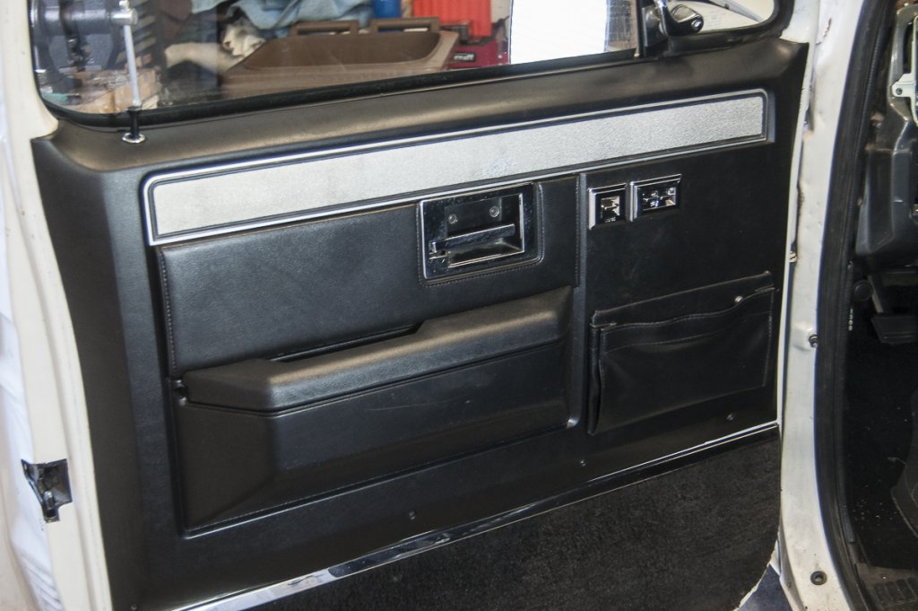

adding p/w and p/d/lock is easy in any year model! :)
