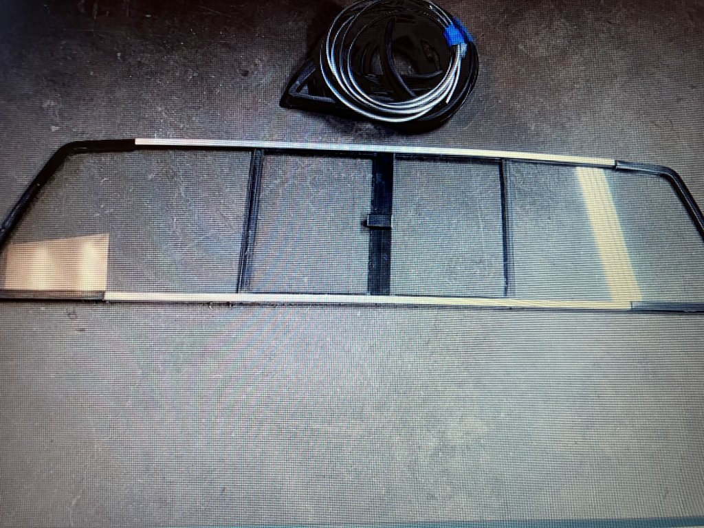

I'm still shopping. One guy local has window that looks just like this one. Advertised with a new gasket and trim piece. I'm wondering if this is a later model window. Seems a little different from the ones with the larger aluminum frame?? Or is it aftermarket.??
Afaik it’s aftermarket. All OE windows I’m aware of are double sliding panes.

I think that one is double sliders. Missing the trim piece on right hand slider. Maybe?
You’re correct. I missed that the slider that’s obvious isn’t large enough.
But yeah it won’t close tight or lock without the other trim piece.

This is the one for sale

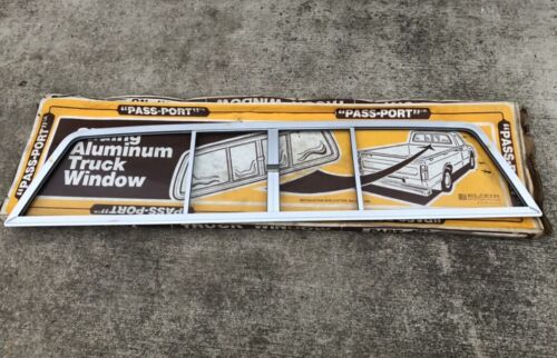

I purchased one of these NOS aftermarket sliders that looks factory, but takes a one piece window gasket.
These Pass-Port Sliders are the closest to Factory Sliders.
They’re good quality and use the same window seal as solid glass rear windows.
There is one available on ebay…
