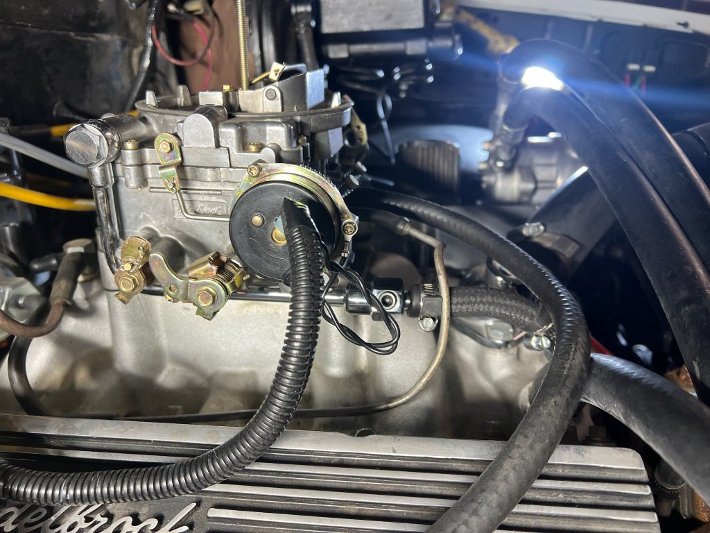

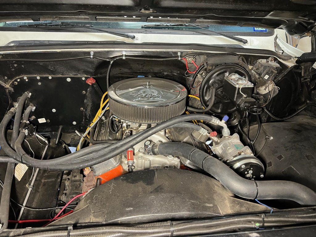

Agree, we used tape and it always leaked. Used pipe dope on it. When we installed chrome fuel line it leaked as well and Edelbrock recommends dope on the fitting and its dry now..
Randy and E
