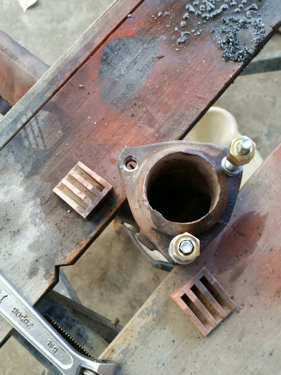

I drill them out all the way and instal heli coils into the manifold. I dont know about Canada but here you can find a kit with the studs you need and some big ass brass nuts. Both trucks I did this to had springs to begin with but I left them out and used big brass nuts.
I did this twice to the 85 because the first repair I used the kit with springs and a regular steel nut. After only 2 years of driving it in ARIZONA the nuts did not want to come off, studs snapped off where they usually do and I was back to square one with the exception of drilling through harder studs stuck in the manifold. Brass nuts just come off or shear the threads without damaging the studs. I actually red locktite the studs into the manifolds now since I cant **** them up with brass nuts so there really is no reason to remove them again.

At Carquest where I got my 2 sets of studs, lock washers and nuts, the nuts are the long brass ones. I have been using those since the early 90's. They are far superior to the steel nuts that freeze on the studs. The brass ones will scream and squeal when removing them after a few years, but they don't seem to freeze onto the studs.

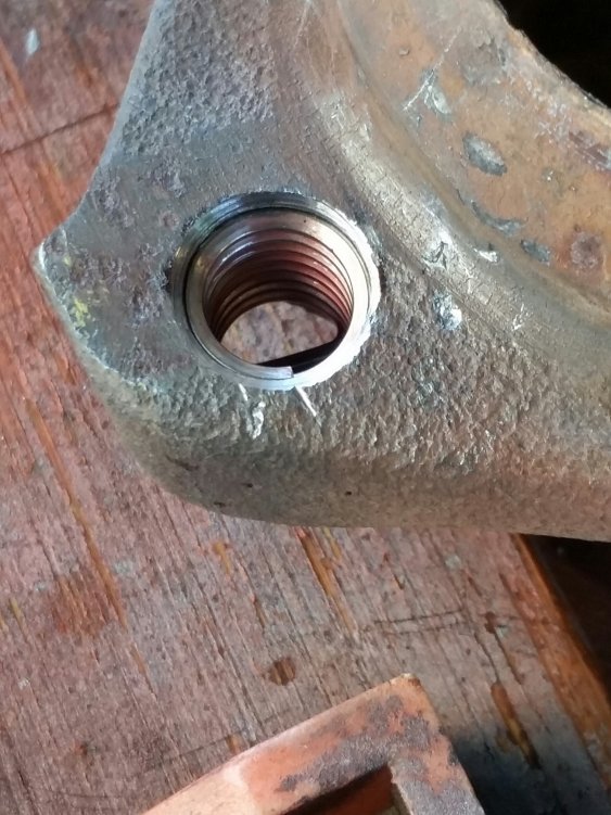

How difficult is it to put in helicoil? The one stud that gave me fits caused my tap to wander and now the stud wobbles a little in the threaded hole. There was a small piece of it that didn't drill out completely, so when I was tapping the threads, the tap would bind because the remnant of the stud was actually turning and coming out the other side. I am tempted to just run it like that because it's not a lot of wobble, but don't want to do a half-assed job, so am leaning towards helicoil on that stud so it will be tight like the rest of them.
Do you just drill the hole bigger, tap it for the outside diameter of the helicoil, thread in the helicoil and you're good to go?

They are not hard at all to install, I think the threads are 3/8's and the heli-coil kit tells you what drill bit size to buy. Drill that hole out and run a tap in, install heli coil and your good to go for all eternity.
They are extremely east to install. I thought I was drilling straight, but apparently I wasn't, so the stud is at an angle but it works with some coaxing to get the exhaust bolted up. I was pissed when I saw the stud at an angle. But it's in the truck and things are snug so all is well.
I spray painted the mainfolds with Ace Hardware 1000* Gloss Black paint. I know it won't last, but it will look good for the photo session before start-up. :) I will put those pics on my build thread when I get them taken.

I did the same thing, one of my studs was a little off.
If you ever wonder about the strength of a heli coil I used one on a connecting rod in a briggs lawn mower engine. It held the bearing cap on so they must be strong.

That's good to know. I have 9 more of them in case I need them in the future. Definitely a worth while fix.
