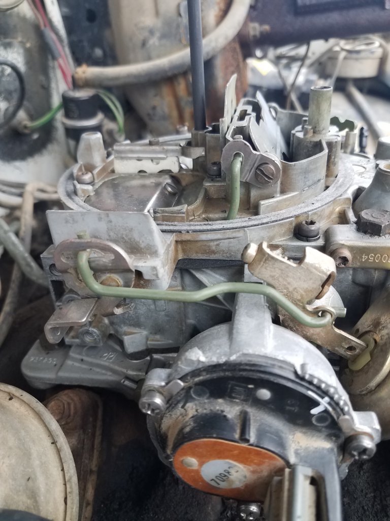

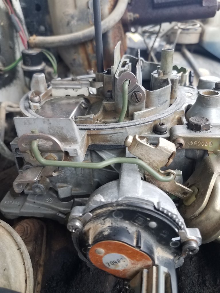

Update. So I let the engine get up as hot as it'll go. (Around 150) and the choke was only at about 45 degrees. Measured 14 volts at the choke. I adjusted the choke and now it is fully open. There was a loud hissing and sure enough, when I sprayed starter fluid near the primary throttle blades, the RPMs changed. When I did the rebuild I did notice that the shaft was a little sloppy but I didn't think it was too bad. Guess I learned my lesson. But I do have a question. Wouldn't a vacuum leak cause a lean mixture? Not rich? I'll keep updating with anything else I find.

A vacuum leak many times will create a Rich mixture because at low vacuum the carb thinks you are accelerating or in a heavy throttle condition so it adds fuel from the power circuit. A lit of people have a hard time understanding that. But your car uses vacuum to determine fuel requirements. Another fun fact a bad plug wire will create a lean condition even though you can smell unburned fuel. Because the dead cylinder is pushing 14 parts air but only 1 part fuel. Make sure the leak is actually throttle bushings not a hose off or broken base gasket.
