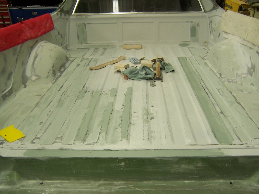

Buy a new replacement. It's all bolt in except 2 small welds in the rear corners. I am currently repairing the bed on a Ranchero. No parts are available and the way it is constructed would have to completely cut the rear of the car apart. I have over 40 hours in it so far and expect to have about 100 when done. What I am saying is replacement floors are available for SB. Other than the hit on your wallet that's the way to go.
