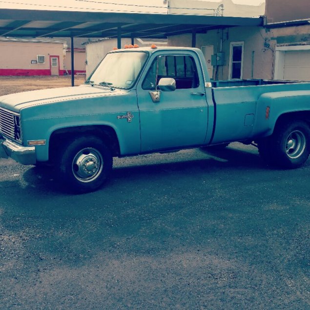

Hello everyone this is my first post here! Well let's get started. I picked up a 1985 Silverado c30 that's in pretty dang good shape with the 454. It has a few bugs I've been in the process of working out and the one I'm on now is not having reverse lights. The truck originally had a manual trans in it which I didn't find out untill recently when I noticed the clutch pedal tucked behind the carpet and so I felt the trans tunnel and can feel the hole for the shifter. My question is could the PO have left anything out in the swap that would make the reverse lights not work. They did replace the steering column with a column shift. I just ordered a new column because while tightening the tilt I noticed some cracked prices in the old column. I'm leaning towards the neutral/reverse safety but figured I would ask first.
