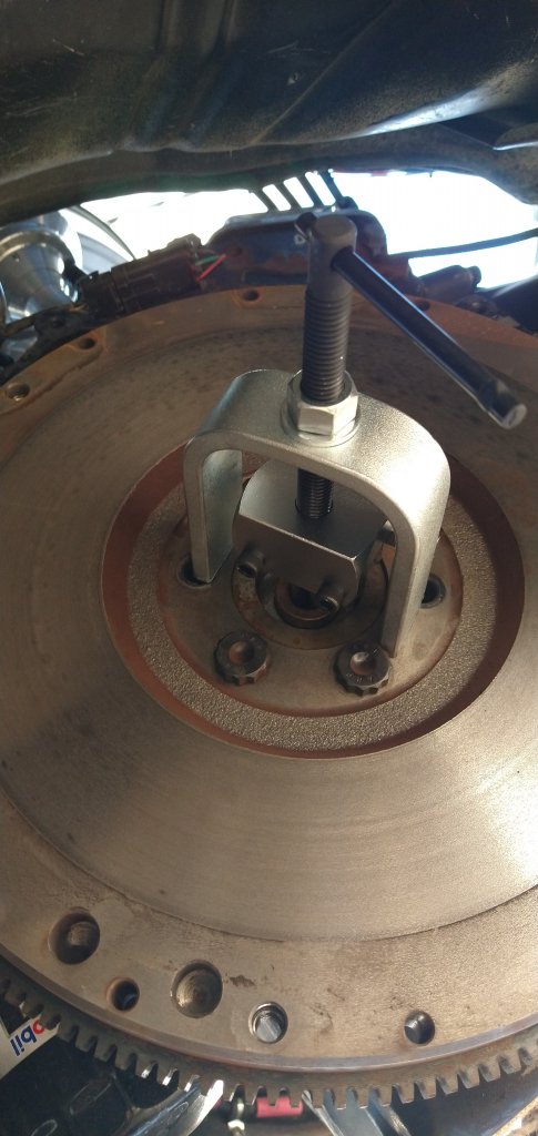

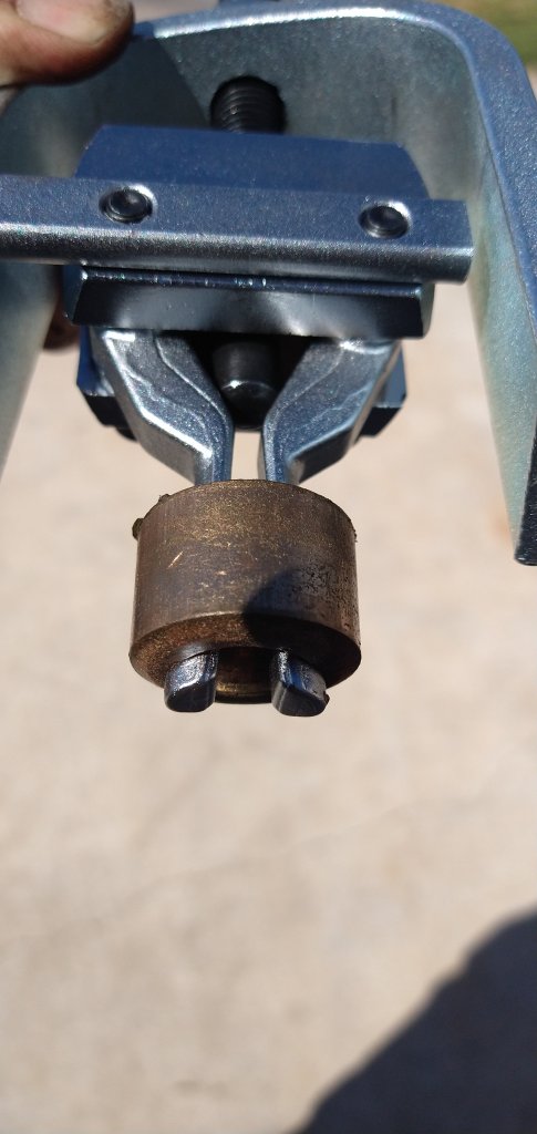

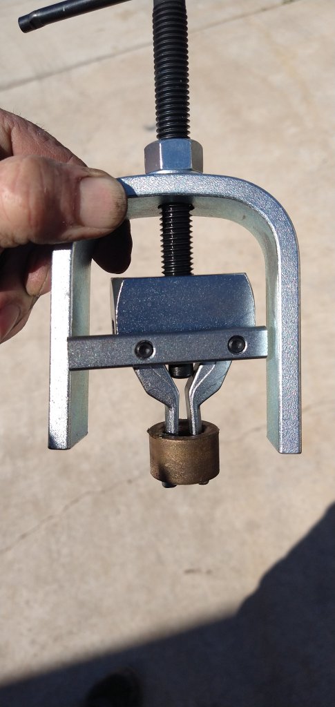

Update. Job complete. Decided to stop by Harbor Freight just for the hell of it. Low and behold they had a Pilot Bearing tool for $20. Pittsburgh brand which I have been generally impressed with for basic tools. That tool was worth every penny. Super easy, no mess. BTW, it was Freiburger on Roadkill that debunked the bread trick. Maybe he didn't know what he was doing?
The reason about swapping it with the clutch in place was to avoid taking the hydraulic clutch components apart and possibly having to bleed the system. I don't think it would have been worth the effort.
