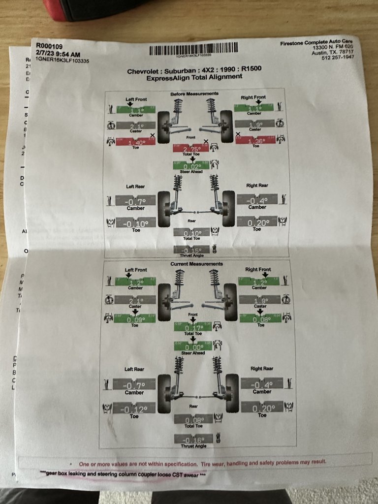

Okay if you've adjust the tie rods to where you have toe out the cars going to be unstable,that's actually a race car trick to enter turns quicker. I'm busy but looked at your print. Left rear is -.2 right is +.2 your rear axle has shifted. If you payed for a frontbend alignment and not a 4 wheel alignment,then I'm with Firestone on this one. If you weren't concerned about the rear,they shouldn't be either and if you asked for an alignment and it didn't fix your problem.Than you are the one who mis diagnosed it,it's not that Firestone failed to fix it. Not trying to make you mad,and I honestly don't know everything that's transpired. I'm not trying to defend firestone,they suck,but I can't tell you how many times a customer or service has told me do this or that, and then ask me why isn't it fixed BECAUSE THAT WASNT THE PROBLEM! I've asked for diag. time to check things out before and been told just do the tune up or whatever.

Goid catch @Radiohead I was so concentrating on the rearend complaint and the no test driving complaint I didn't even look at the front numbers,just assumed they were right. Camber,Caster and toe are adjustable angles on your truck. I'd like to know why they weren't adjusted. And you can and I do set caster and camber at home,but you have to know what you are doing and have the right tools. I don't think it's a good idea for you.

The one in black and white is the most recent one.
Ummmm… these are the same alignment and same date. I thought you said it had been in twice.
All they did (at least on the sheet) is set the toe.
I know some shops will only make adjustments for their advertising price, if adjustment cams or other parts are needed they don’t even look at it unless you sign off on them replacing whatever is needed.
If thrust angle causes it to be crabbing down the road (dog track) as gritdog said that would end up in a slight turn of the wheel to keep all wheels pointed in the same direction. Not the same as a pull, a pull drags the vehicle one way or another requiring constant input on the steering wheels to keep it in the lane.

Sorry about that, here’s the sheet from the first time I went.

And yes 0.2 deg rear axle shift is not an issue in any way shape or form likely.

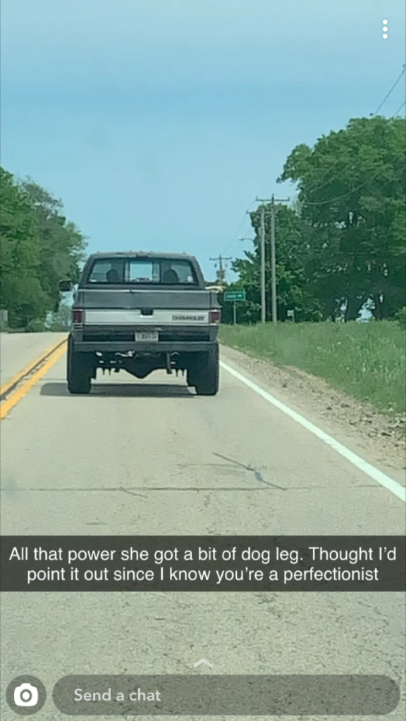

check the leaf spring centering pins/bolts. My truck dog tracks to the right and thought I had a bent leaf spring hangar bracket, bent axle tube or something majorly out of whack but come to find out both leaf spring centering pins are broke and it has allowed the leaf springs and axle to shift under the truck due to this. I've had the centering bolts and new u bolts to put in since last summer but haven't been able to install them as house work took priority and the truck has been out in the in-laws shop since last summer. But that was the cause I discovered on mine. I had had the front end checked on it after rebuilding (forget the numbers) but it always wanted to pull to the right no matter what I tried and is a little squirrely (not scary but noticeable) when you hit big bumps at speed. Got looking closer after a buddy sent me this snap one day and I was like "that rear axle looks way off" and that's when I discovered the busted bolts and the axle shifted under the truck.

That rig needs MORE positive caster on the PASSENGER side....CASTER pushes...CAMBER pulls...and it looks like there is WAY too much camber on both sides. In my part of the country we set Camber at 1/4 degree positive or less and try for as much Caster as we can get, with a little MORE positive on the passenger side......this has worked for me for over 50 years. Also we aligned the front end to the thrust angle, which may make a difference, BUT the printout says they did NOT do you any favors!!!
