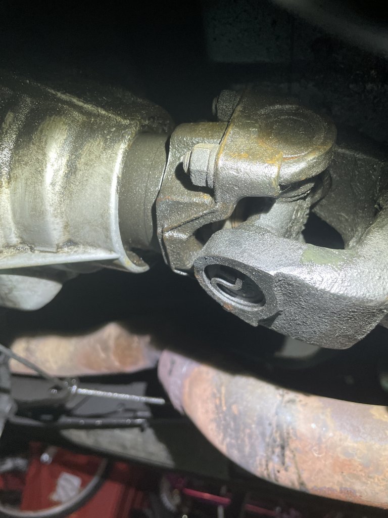

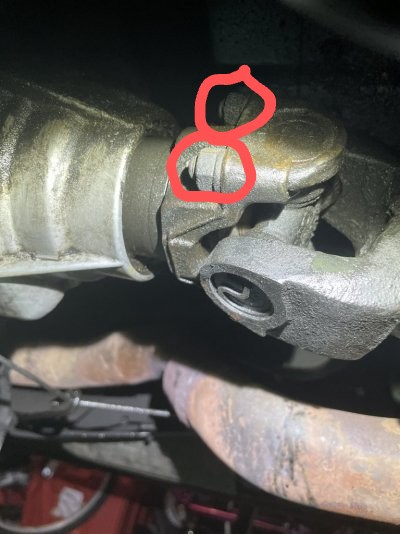

You can’t really see the leak. It looks small but last week when I first found it I cleaned the puddle up and stuff and waited a day and there was a pretty good sized puddle. I hope those are good enough photos. If not I can take more

No big deal.
You'll have to remove the driveshaft from the rear differential first. That pinion is a slip fit and removes with the driveshaft towards the rear of the truck.
The new seal is just like the grease seal of a brake rotor. Out with a flathead , in with a hammer.
Good luck.
*Dexron 6 is the correct fluid.

If it's a 203 case,motor oil is the correct fluid. We used to put the same oil in the 203 transfer case as what we put in the engine. It also looks like that is a bolt on yoke?
