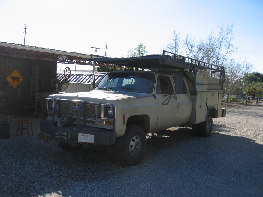

so I did mine with rattle cans, also flat. I used avero military paint, desert tan. it's the color that the military uses for their desert paint. on my crew cab with service body I used 4 cases. at 6 cans per case that is 24 cans. and my truck was 6 different colors. of course I sanded the whole truck, where the paint was in good shape I just painted over the sanded factory paint areas that needed work got primer. let me tell you this paint is tough and it's easy to touch up. I painted it 12 years ago, it needs to be redone this time I will buy gallons and a gun. btw avero is kylons parent company. highdesertranger
