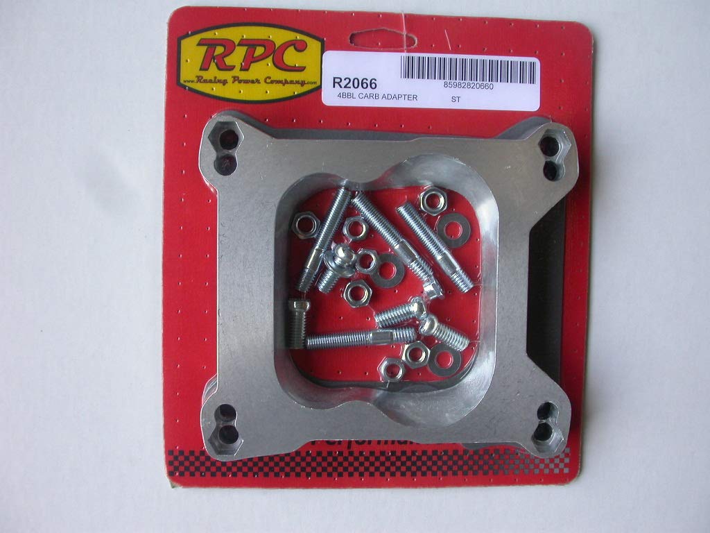

My '73 Chevelle still has a stone stock (well, mostly stock now) 2bbl 350. Looks like it's never been apart. I put headers and duals on it because the stock y-pipe was rusted and crushed. There was a definite power increase, but a large part of that was likely due to the restricted stock exhaust. I later removed the Rochester 2-jet that I had fully gone through, bolted on an adapter and then installed a 500cfm Holley 2bbl. I was shocked at the amount of mid range and top end gain after the carb swap, with no loss in bottom end power.
The used headers I got in a trade with other stuff, figure 50 bucks there. I bought the used carb for 20 bucks, then overhauled it with parts in stock, maybe 20 bucks invested there. Then the adapter to mount the Holley was new, I think around 35 bucks. Oh, and there was about 100 bucks wrapped up in the home-brew exhaust that dumps at the axle.
If I were to end up with another car or truck with a 2bbl 350, I'd do the same thing again. It was so much improvement for so little money and effort.
