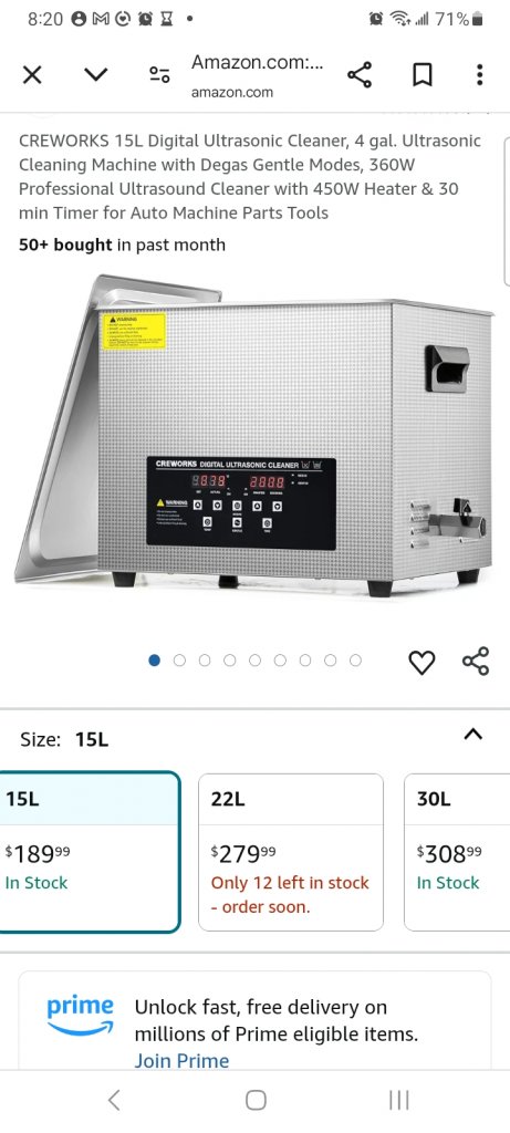

My unit has a heater, but supposedly preheating makes life easier on the tool itself, I read that placing parts directly in the tub is hard on the drivers and wears holes in the tub. So that's a little explanation as to my questions. This is what I bought haven't even put water in it yet to play with it.Specificaly bought it for rebuilding carbs,I probably will find other uses,but that's the intended use. Hanging the carbs in it is the best idea I can come up with.
