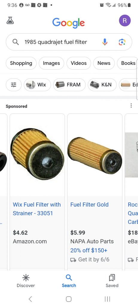

A new Qjet filter with the valve is about 5.00,10.00 with a new spring and sealing washers,why search for a valve separately on the internet. Adding an external filter in most cases ends up with the nice OEM steel hardline replaced with a rubber hose 4 clamps and a plastic or glass filter. Or the O.E. line cut 2 short pieces of hose 4 clamps and a filter. I'd rather have my O.E. hard line intact and change my factory fuel filter regularly. I've personally witnessed 3 engine fires started by leaking fuel hoses.[/QUOTE]
