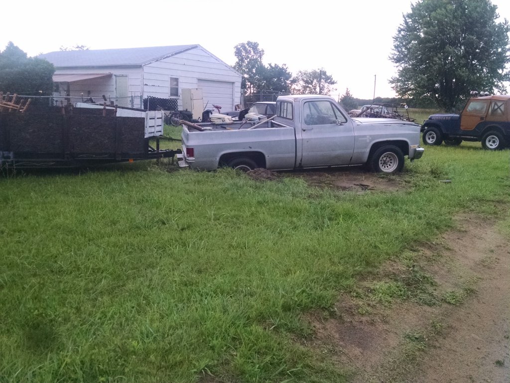

pickup is in town, i'll go by there and grab it. everything i saw was in tolerances, bushes looked brand new last time i checked, 10 yrs ago. this is why i changed all parts, nothing left to chance. steering wheel back to center each way. pitman arm wrong length maybe? not tires, its been doing this when i first bought it, and tires wud show signs of wear, its a smooth ride, always has been, until i let go wheel, its not a hard pull, i can just hold ten oclock position and relax arm on window opening, winter kinda suks no arm rest up high, anyone know off hand length off tie rods are center to center? yes wheels are same , tires same, never checked threads on tie rods , good call i'll do that , can somebody measure theirs, including center link, Totally hucked torsion bar is that what your referring to, or stabilizer bar.. chevy has stabilizer to help keep downward pressure on A-arms in turns, fords use twin Ibeams with torsion bars to hold them in place, i'm gonna run to town snap pics , gets measurements, alignment page if there that was like 18 yrs ago, thats great tire wear, probly less 30k miles , i'll get back late tonite or early morning, thanx guys for possible situations:grd:
