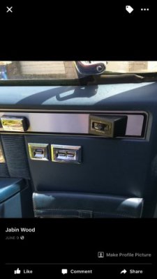

Here is a pic of my 86 K10 LH door panel w/Suburban switch mounted on Silverado insert for a factory look. I used G20 power dumbo mirrors. I've got power mirror conversion harnesses using both the Suburban type switch as well as the 3rd gen Camaro/Iroc power mirror switch which is similar to the G20 van style switch. I just finished building a power window/lock/mirror harness for my father in laws' 1977 GMC High Sierra using 1991 Suburban doors so if anyone needs/wants a complete, NEW factory style harness, PM for details! I've got the harnesses covered for these trucks-you just need to source the parts! And bye, the van power mirrors require just a slight amount of trimming to fit the pickup door contour better-the bases are different because the van doors are more flat where the mirror mounts vs the pickup.
