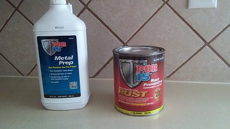

Nick
Got to use the metal prep. Got to Got to

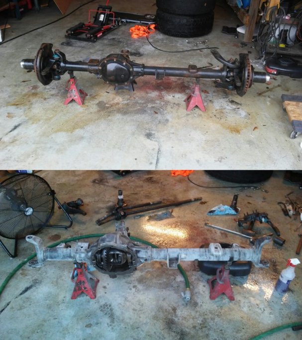

Nick
Top pic of axle is before I wire wheeled it, bottom is after I wire wheeled it and used the metal prep. It primes the surface for the paint.
