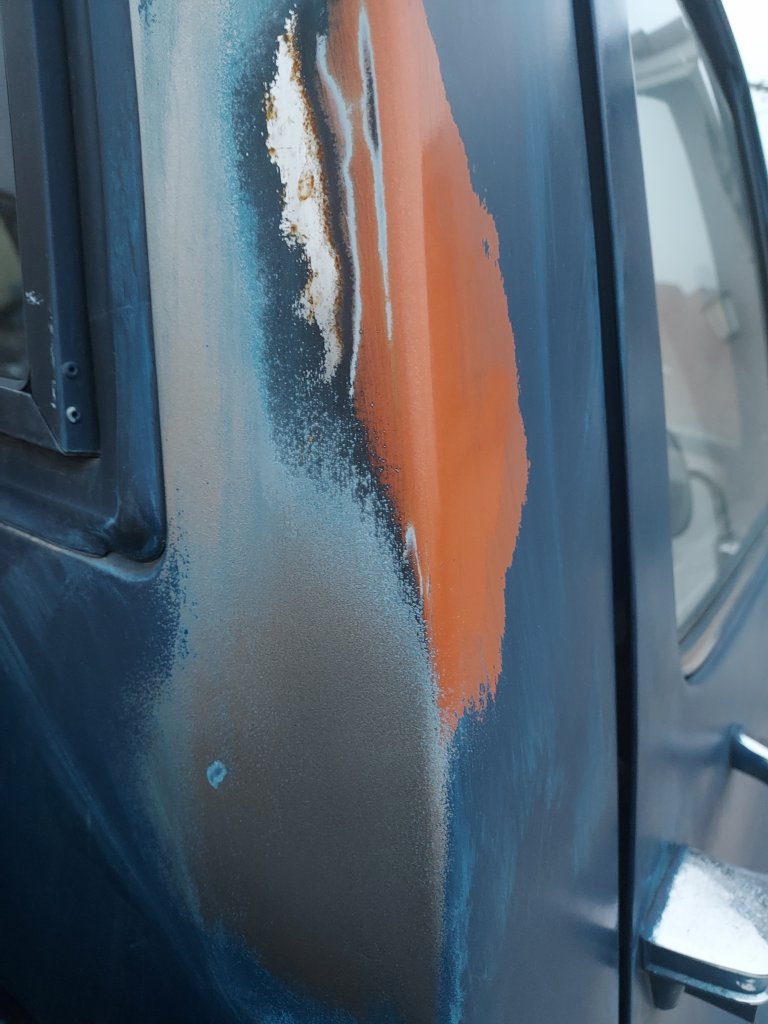

It has been rattle canned blue, under the blue is burnt orange and under the burnt orange is silver but on the doors under the silver is black. Is there a way to find the original color with out the spid because it's gone?

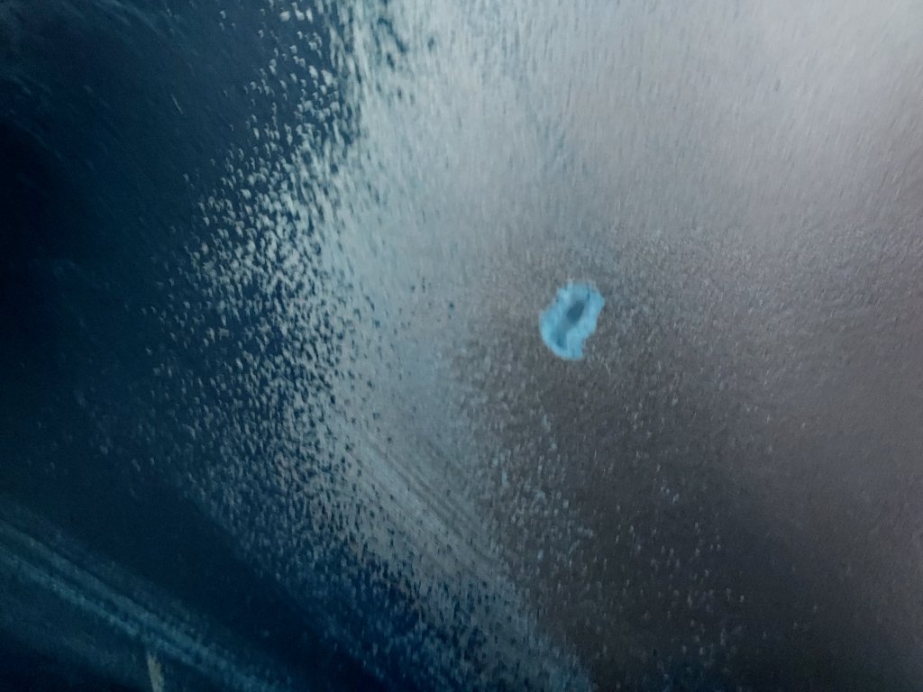

I also noticed some blue under the silver is that primer or possible original color

That's a starting point. The original color may have been silver or the silver was at least the last thorough respray that the truck received. To know more, you need to remove interior trim panels to see what you find under them. Very few people go to the trouble to repaint areas that are not exposed when the truck is assembled.

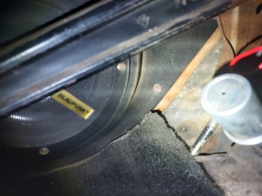

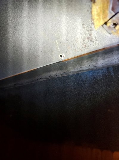

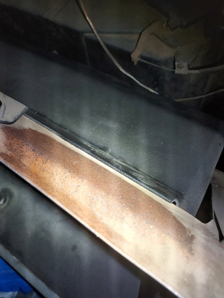

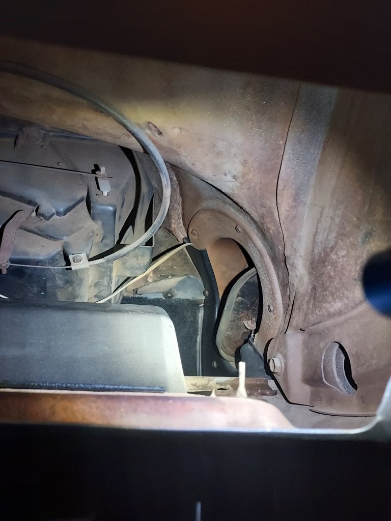

This is what I found behind the dash

I guess I should have specified. Under the dash pad, but not the backside of the dash that didn't receive a coat of paint to begin with. But there does look to be hints of original yellow or ochre paint.
