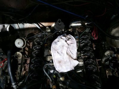

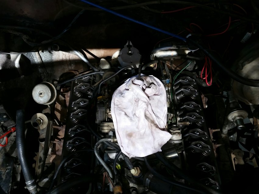

Opened 'er up and this is what I found
DoubleDingo
Jul 3, 2012
11,463
17,737
Right where I am
Bagoomba
Carb'ed Vortec 350
Valves adjusted and almost ready to button it up.

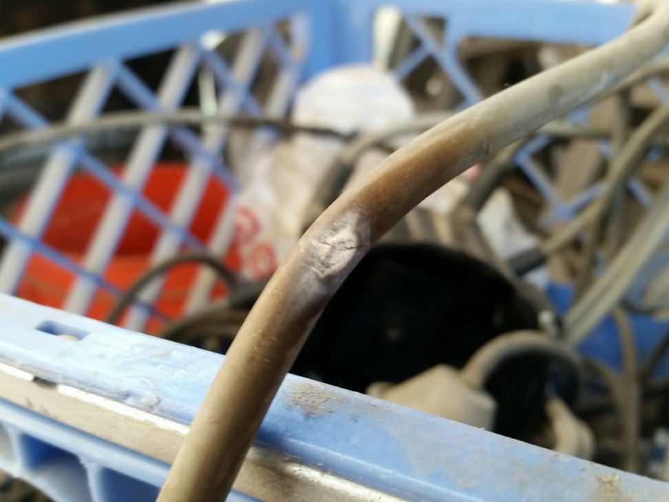

I have an extra HEI distributor from my '65 that has been sitting in the storage/work room. It has higher quality cap, rotor, wires, etc. So I dug it out. When I was removing the cap and wires from the engine so I could add the better stuff, I saw this wire touched the exhaust manifold on the passenger side. It still ran well but the way my friend routed the wires when we did the vortec swap, it is a wonder it took this long for it to make contact. I should have checked his work before running it all this time. It's okay, got some new plug wires when I got new oil and filter, because one of the wires from the '65 didn't have a contact for the spark plug.

I didn't get any pics of the finished product, I was hungry so we went to get a late breakfast after I buttoned everything up yesterday.
47,132
9,331
It appears you did the right thing by shutting it down and getting it towed home. May have avoided a catastrophic failure and not been so lucky had you limped it back home.

I may be a little late and may have missed it, but in the original picture doesn't it look like the rocker on the next cylinder forward look a little angled also. Would that be #5 intake?
47,132
9,331
He changed all the rockers and all the push rods, so it's all good now. It is likely there were others soon to go too. I think he realized he had the wrong push rods, and/or rockers.
Yeah, all of them were angled, with some worse than others.
The pushrods were okay as far as length. If that one wasn't bent I may have reused them. But I replaced them since it was cheap insurance while I was in there.
