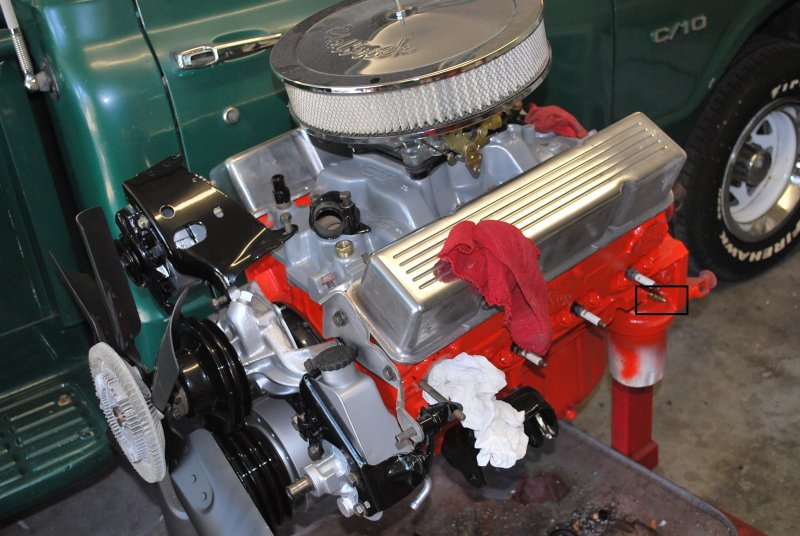

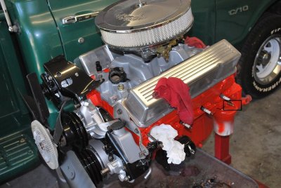

Should be a plugged off oil port right above the oil filter.

I think that may be where the 3 wires are coming from. I will take a look this weekend. Thanks

Had to do a little engineering because the gauge sensor is short and fat and 1/8" instead of 1/4" but its in and working. Thank for the help Robert. Now onto the volt meter!!!
