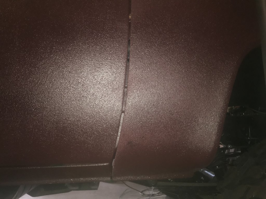

Here's the fit of the OER fender I purchased 2 years ago. The fit isn't perfect, and the metal is noticeably thinner than the original. But my truck is more of a play toy, not a show truck
Thank you for the pictures, this is exactly what I was trying to avoid. In all fairness, the OEM fit and finish is just marginally better.

Yikes, that's the worst fender I've ever seen lol. We really don't get any complaints on the ones we sell other than the "wish it was OE thickness". I've never seen a bodyline curve like that :Whoa:

I've seen some doosies, lol. Some of them over the years have been shaped wrong in every area of the fender. They tend to pop seams too.
