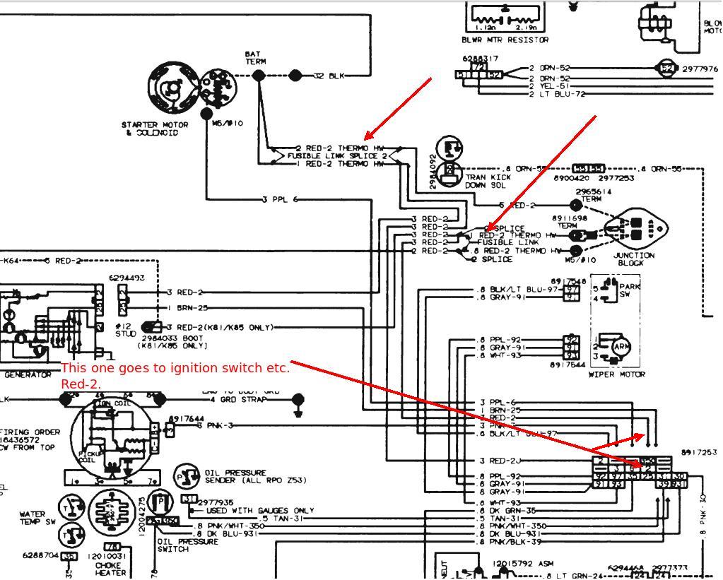

86’ C10 SB350. Everything was great, parked the truck after work, in the morning everything connected to the ignition is dead. Battery is fully charged, headlights work, starter turns over fine with remote seater switch. But cab is dead, fan is dead, no start from the key, no power to distributor. I’ve checked the connections at the alternator, starter and battery. Any suggestions?

Check the fusible links- they are in two location- I marked them on attachment. The Red-2 wire I marked would go to the ignition switch that feeds a large portion of your fuse block & the fuse block itself( for hazard lights). If your headlights works, your BAT portion of the fuse block should be working- horn, tail lights, courtesy light.
If your hazard lights work- I would be looking at the ignition switch first. (hazard lights are fed by the same red wire feeding the ignition switch.)

Didn’t think that was it the first time I looked at it. But, went back and checked again and the wire fell off at the terminal. Problem solved, Thanks.
