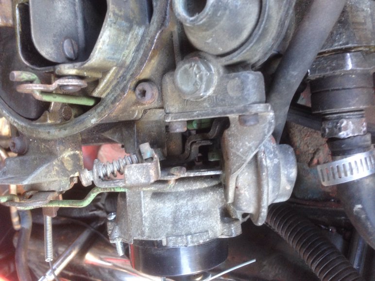

No power up hill or after 45 MPH

Should something be touching where that spring is?

Sorry guys, I'm not sure why they're all sideways.

Indexed correctly and twice as big:

Thanks Jerry
I would say for starters get a couple cans of carb cleaner and spray all the linkages down real good while trying to move the throttle back and forth.
I would also check and make sure that the Secondary Throttle -Blade Lockout tab is allowing the secondaries to open. You need to check with the engine fully warmed. Its a little tab on the passenger side that locks the rear secondary throttle shaft from rotating until the engine is warm.
I circled it in red
