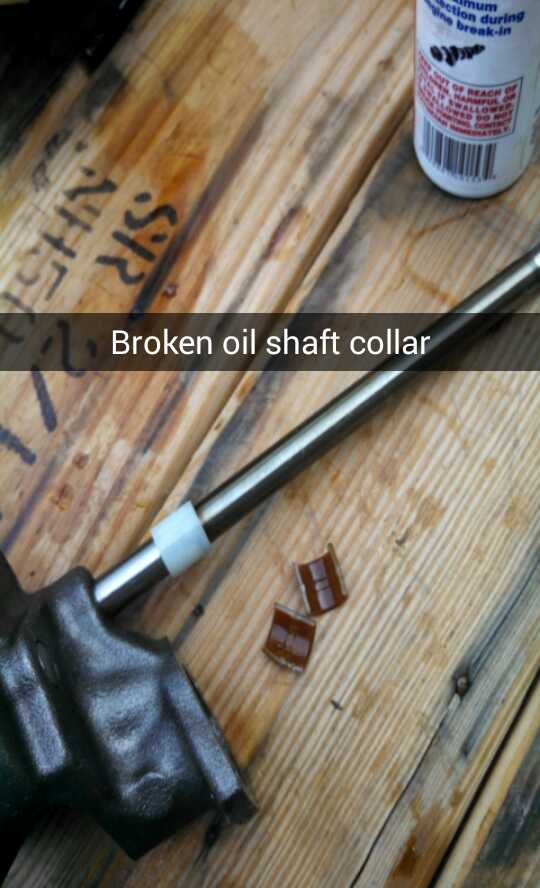

Well I replaced the pump anyways but when I dropped the pump the drive shaft was loose and the collar was broken. The bolt on the pump was also finger tight. All I can think of is it wasn't meshed with distributor when I torqued it down

If it isn't too late, spend two or three bucks and get a steel collar for the oil pump drive.
They won't break like the nylon one did.
Hey bud you got a part# for this?

NAPA p/n SEP 22443353 $5.99
They went up, I bought mine 14 years ago when I built my 383 stroker.
I'm sorta funny about having dependable oil pressure in my engines, it's six dollars WELL SPENT.
