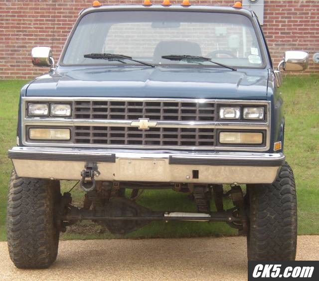

Most people will tell you that hooks are a bad idea. They usually break, sending flying chunks of metal that try to kill everyone watching. Your hooks must be better quality than most since they ripped through the frame, but shackles are the way to go. Your best bet is to copy a cucv bumper. Photo courtesy of CK5.

Factory recovery hooks are meant for light use, not heavy pulling. Even though they can, I don't think GM intended their trucks to go anywhere that can get them REALLY stuck. I think they are mainly there so you can easily pull your neighbors car out of a ditch on a snowy day.

And there is certainly a difference in tow hooks and recovery hooks. As said, I'd copy a CUCV bumper. Those are intended for recovery.
