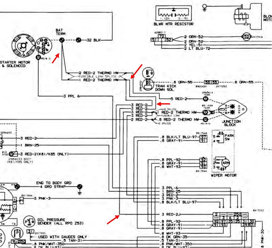

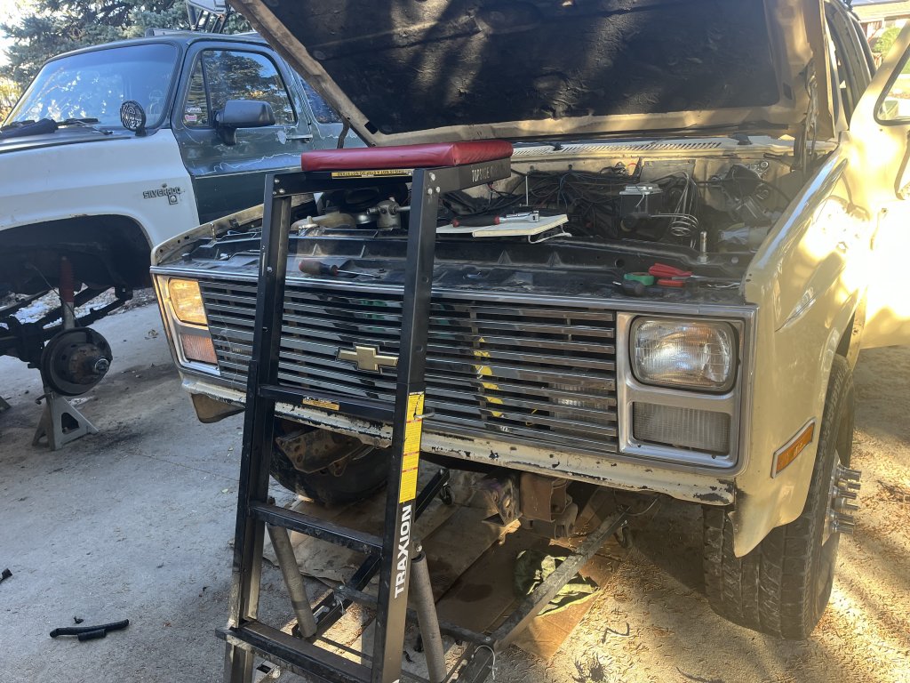

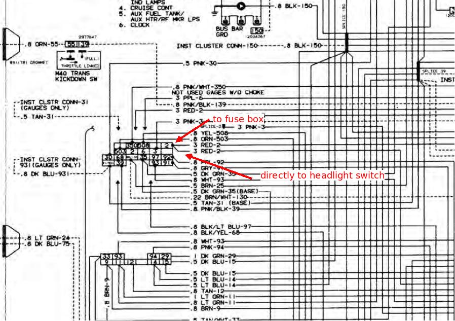

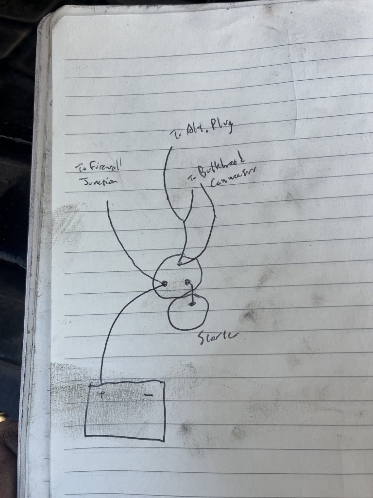

Finished putting my truck back together and it runs great, but I don’t have any lights (interior or exterior). Went through the whole troubleshooting process and found that my wires are good (continuity tests passed), but I’m still not getting power to the headlamp switch. I think I narrowed it down to a faulty “s” terminal on the starter since I can jump the two s terminal wires to the junction block on the firewall and I kinda get headlights (see pic below). Just wanting a sanity check that this is the issue. I also drew up a bare bones wiring diagram from what I’ve found
