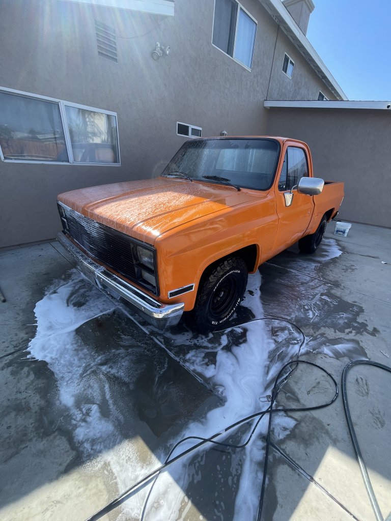

Hey there fellas my father just passed down his 1984 gmc short bed in hopes I fix it up and get it running real nice. Me and father did a lot of cosmetic things to it as a start but I want to get it real dialed in not cosmetic but mechanically. I’m super new to all this old tech and have no clue where to begin. One of the first things I’d like to do is replace the existing carburetor it has at the moment since it’s been real sluggish and visibly looks dirty as hell. I have lurked on this page for a lot of some minor issues before and I will say it amazes me how much knowledge is spread within this community. Do any of you have any suggestions on what carburetor to look into I have seen debates on quadrajet Holley and Edelbrock but im so new to this I have no clue which one would even fit there’s so many different models. I’m not looking for crazy performance just something that will run smooth with little to no issues and won’t struggle if I do choose to get on the gas. Happy to be a part of the community and i appreciate the help.

Welcome!
Great looking truck, thanks for the pic.
Now give us some shots from under the hood…
