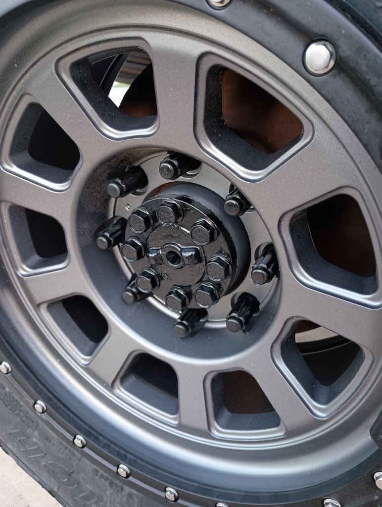

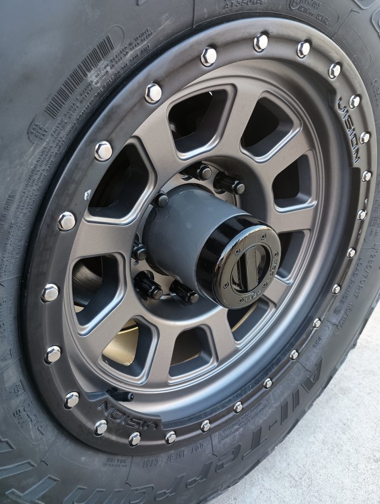

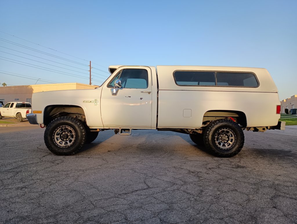

I debated white, black or chrome wheels. Decided on dark grey/silver to match the soon to be repainted OE bumper. It's a more modern look but I love it! If you need hubcaps, I got 3 full sets.
