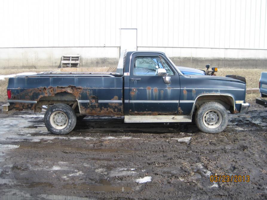

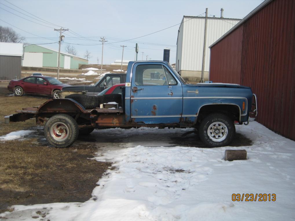

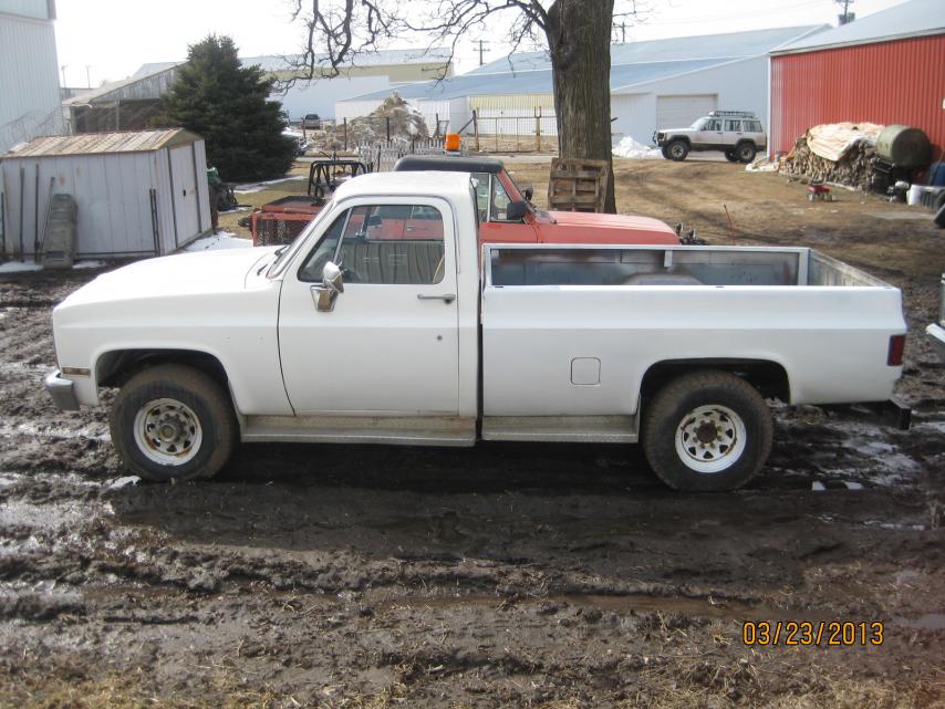

By the time I got the exhaust done on the camry and the bearings and tires on the impala the flu hit me hard, Spent the rest of the day working on a rollable engine rack for the 350. that way I can free up the engine stands. I did shoot some shots of the trucks before I left. these are the 3 trucks I'm going to use to build one.

Ohhh yeah. 2 of those dudes are toast. The White one is the best thing going. But you say it's NOT a 4 buh fo? How are the frames on those ate up bodies???
Looks like a good pair/set of Ralley Wheels might have survived.

The frame on the 78 is good, it sat up till I bought it in the early 90's, then I only drove it a few years and sold it to a guy that drove it a year and the tranny went out. It has since ever since (96) on his dad's farm. thats the frame I'm going to go with, figure coat it with OSPHO and then chassis saver. should last then.
