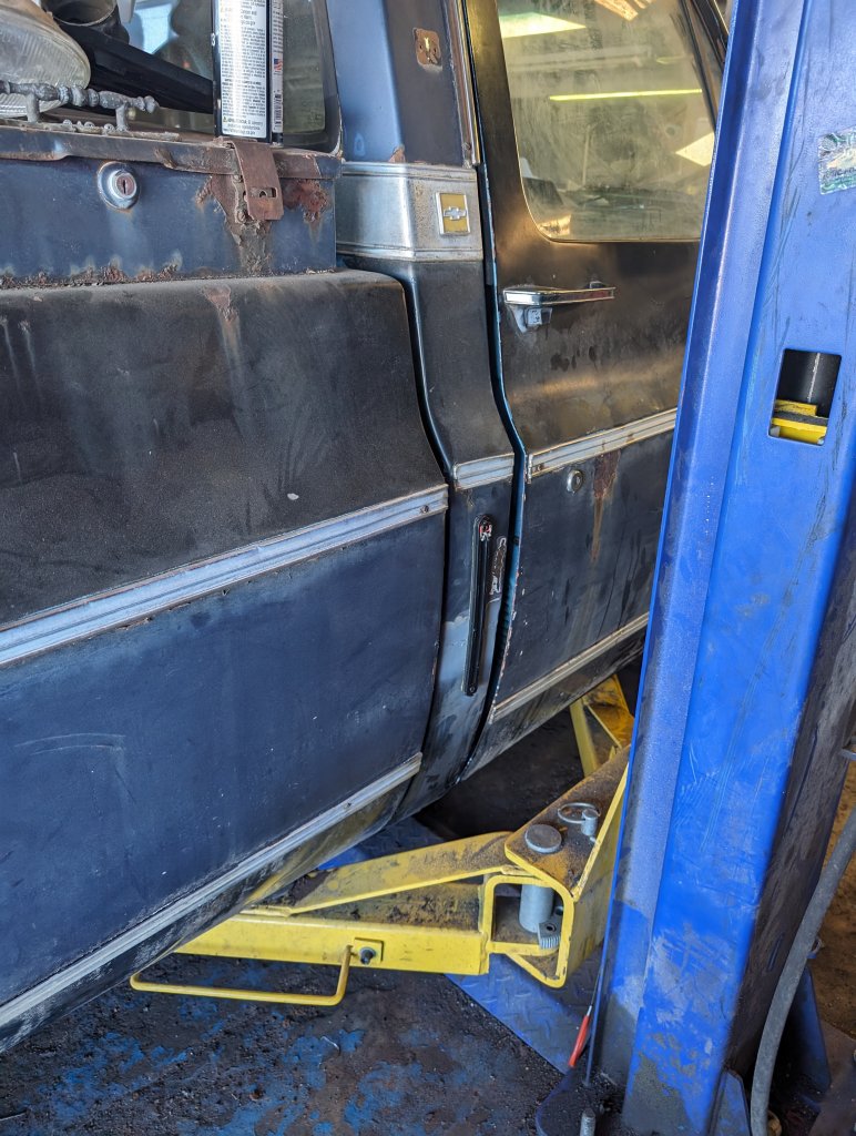

Greetings everyone. In the final stages of a restomod project for my dad and a new pain in the ass for me lol. We finally have the new floors finished and sealed. Now the new weather stripping has been is talked to the doors on the interior around the cab, and low and behold, the bottoms of both doors are bulging out a little. Is this just a new seal issue or do I need to raise some hell about misalignment.
projectmidnight74
Jul 10, 2023
115
65
Mississippi
Eddie
V8
This is a pic. I didn't do the traditional supper slam because he's still getting the gaps right but it was closed.
4,187
7,998
The only adjustment for that is the latches. The seals aren't that stiff. How worn are the door catches?

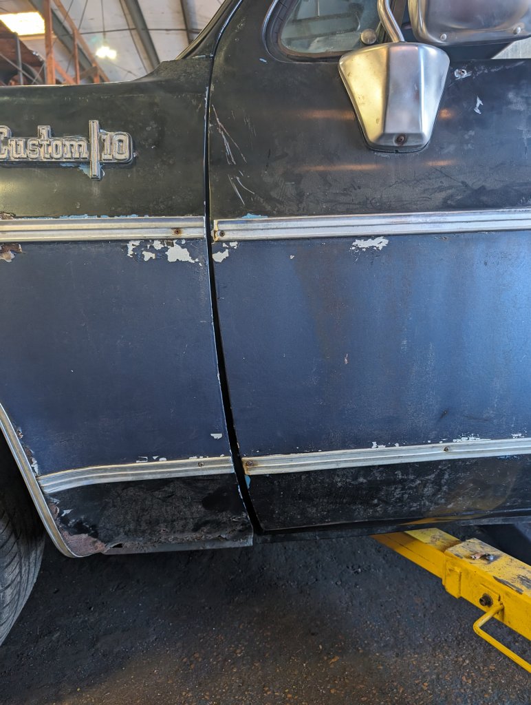

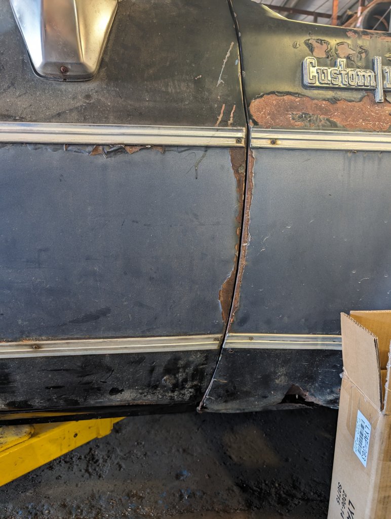

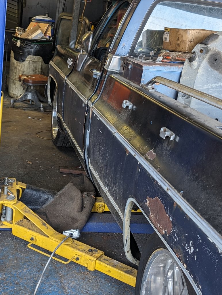

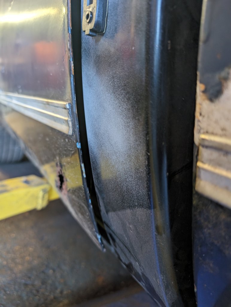

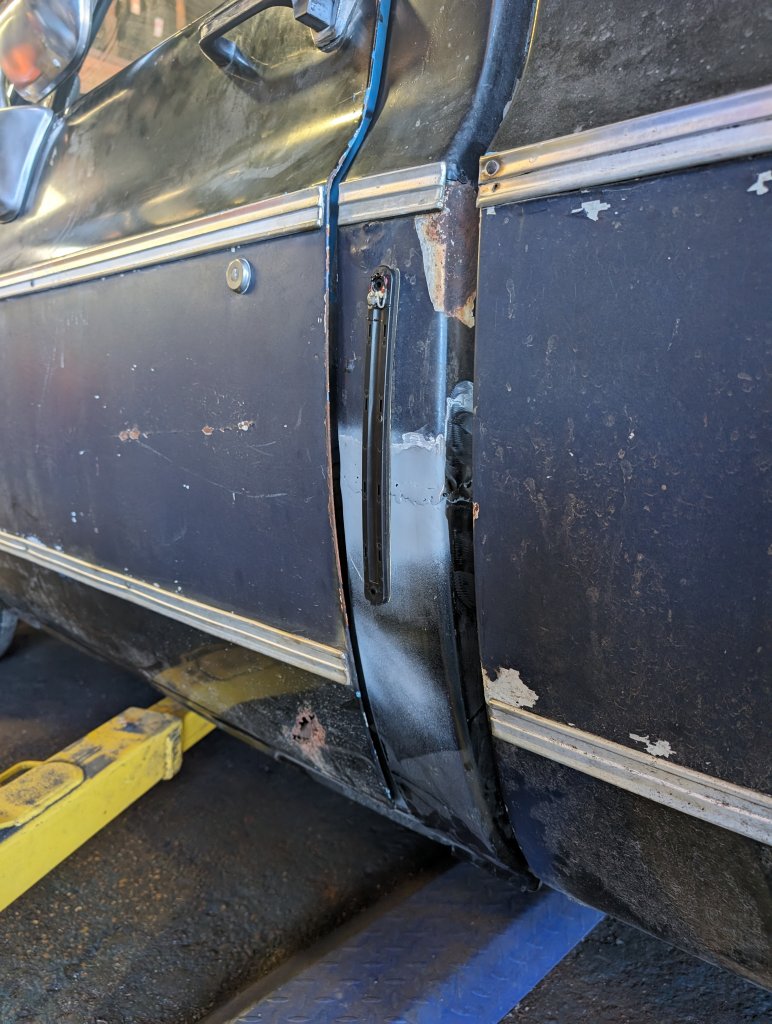

Update. I feel it's an alignment issue. He's saying its a can corner issue since we replaced the floors and inner and out rockers and cab corners. Doors are on but just look at the pics. This is the take over mechanic since the original one is recovering from surgery.
Craig Nedrow
NADAR UNDER THE RADAR
Sep 1, 2018
1,035
2,166
Washington State
Craig
1973 (have two), 1985
K10, K20, C20
350, 454, 6.2 Detroit
The last pic looks like the front of the doors, (hinge side) could be in which pushes the back out at a slight angle, which in turn makes it stick out in the back. When I took off my door, (which fit well,) there were fender/body shims behind the hinge bolts. I have bought lots of stuff from Brothers, and happy with there quality. However they have lots of great videos on youtube. Go here:
