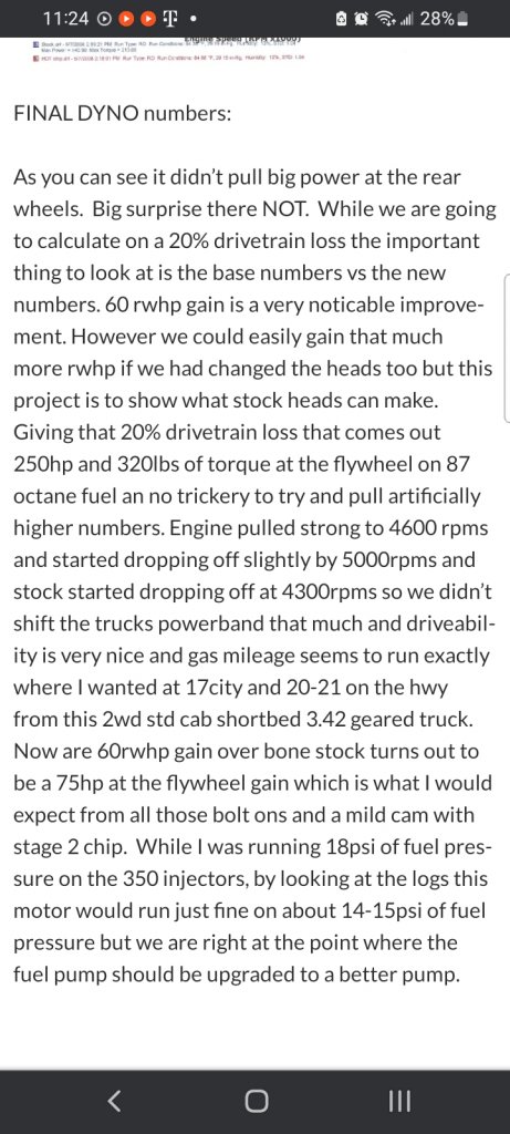

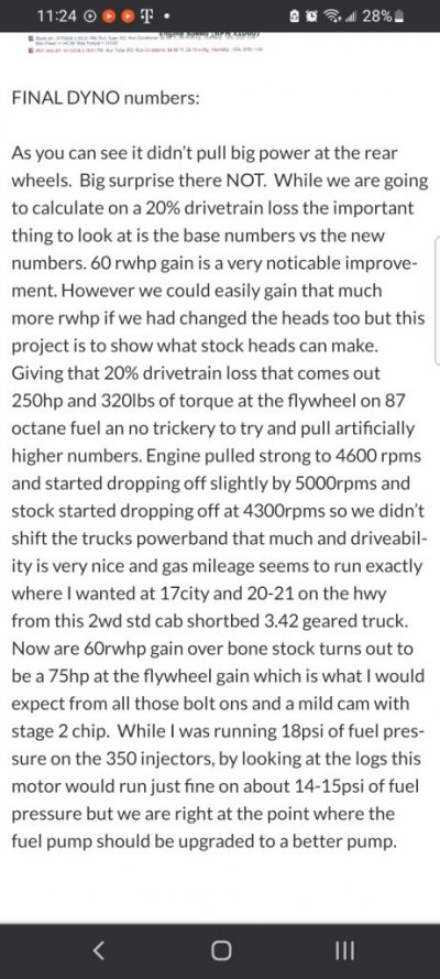

250 hp that can be done real cheap,reliable, and still good on gas. Headers and a mild cam will get you there.
Sounds awesome! Would the stock smog heads do okay, or should I upgrade to something better?
5,323
8,474
This is stock tbi heads,a mild cam,exhaust,underdrive pulleys,and an electric fan. Pretty much a stock 350 tbi with bolt ons. More cam and better heads and you'll get more hp but you'll take a hit on gas milage. But the build below is dirt cheap.
