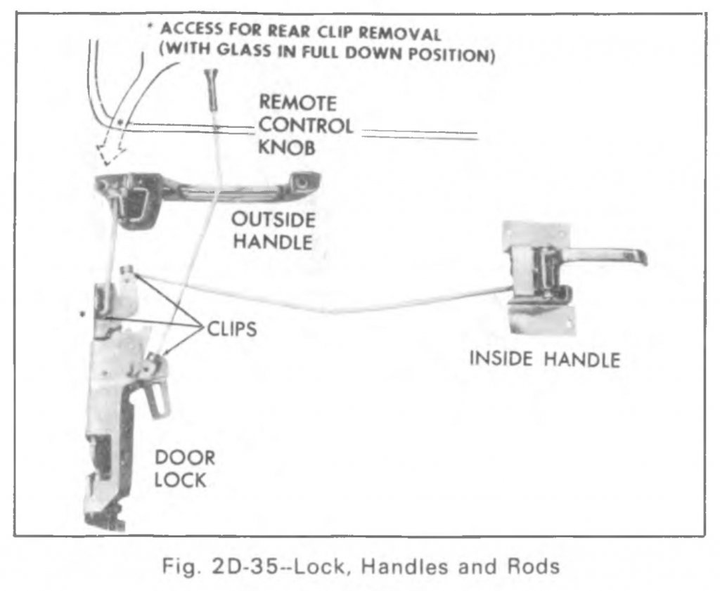

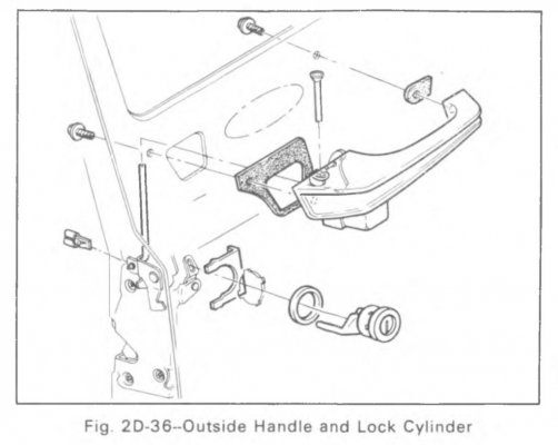

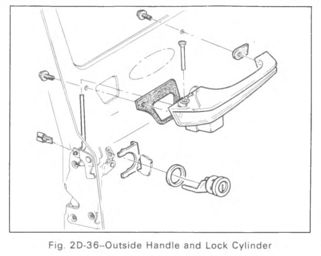

Do these clips from the 1978 manual help at all?

I'd love to have a pic of the entire mechanism assembled....outside of the door shell.
