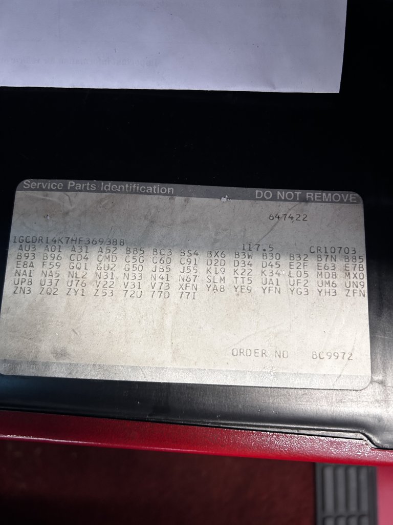

Hey alll. Truck is red. Wondering which number is the paint code. Thanks!
Is it ‘87 Red ? We need more info.. year? There were 4 different reds in ‘87
#71
#72
#73
#76
its Probably #72 Bright Red

Yes - code 72U = Apple Red. WA7475. High solid enamel paint.
Interestingly enough: my '87 was also build in Flint, and the VIN also ends in "xxx388".
Built Monday Sept 29th of 1986.
