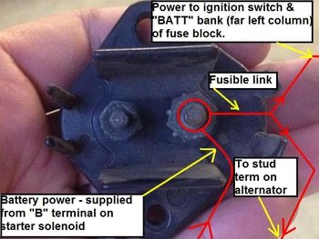

1976 K10 Scottsdale ..I need help with where all the wires go that's on my firewall junction box .I spend alot of time out on the road covering three states and for some reason thought I would be able to remember where they went when it come time for reaasemblej ..When I did my engine swap I didn't take pictures or make a note of where they all go ...I drew a pic what's there now..But I know there are some missing wires...I think there's one that goes to the starter ?..Maybe one to the back of alternator ?...Im not certain that's why I'm on here asking the experts ...Thanks in advance
