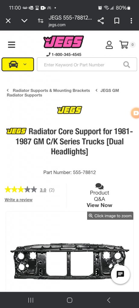

What are you trying to accomplish? Just a stock replacement for your core support,or are tryingbfor a different style? Some trucks only had a single square headlight with a marker light below it. That may be the other part number. The truck in your pic needs this.

For dual headlight set ups, side by side vs top and bottom depends on the year. Horizontal and vertical dual set ups were not both available for a given year.
It sounds like you’re wanting to convert to a dual light set up from a different year than you currently have. You need to identify (and state) the desired year. If you don’t see a clear part listing call LMC.

For an '84 with quad headlights you want the earlier "dual" headlight part (81-87) that has the four headlights vertically stacked and the directionals in the grille.
32-2548-T
If you only have two headlights total and the directionals are under the lights and not in the grille, then you want the "single" headlight part
32-2547-T
