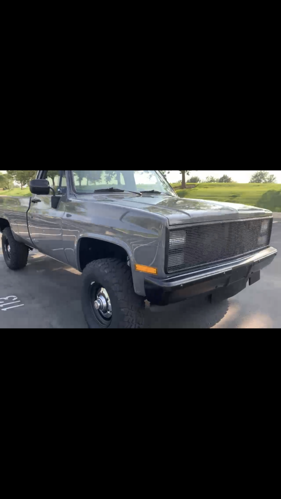

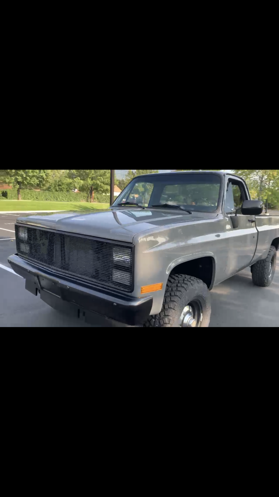

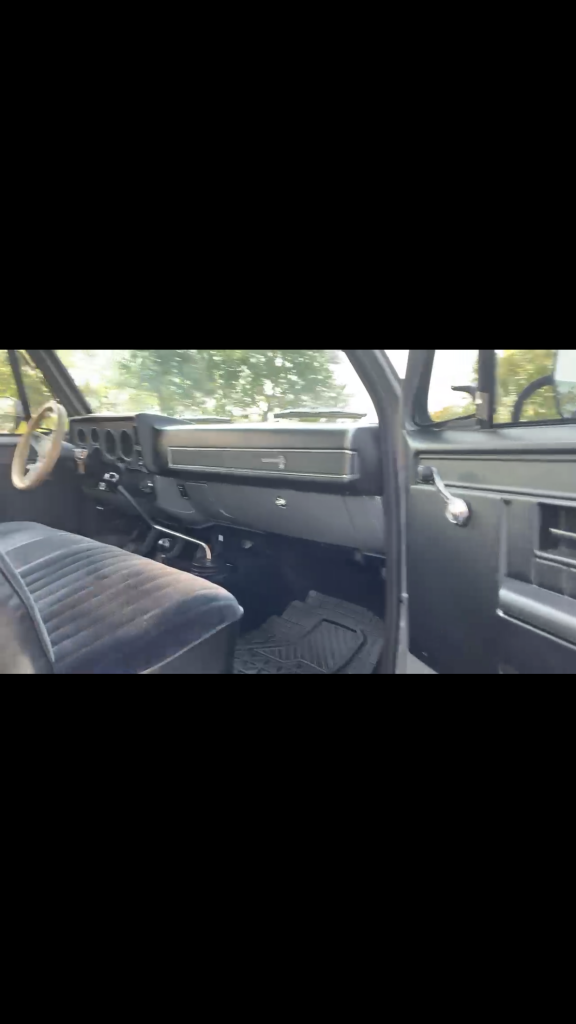

Hello all…I’m new to the forum and I’ve owned a few square bodies in my day but it has been quite few years and I recently just picked up an 83 k30 long bed 4wd with the sm465 trans and 410 gears. This truck is quite cherry with 34k original miles and previous owner put a very nice paint job on it as well as a few other cosmetic changes. The truck runs really well and does not seem to use much oil which I was surprised being that it hasn’t been used much in the last 38 years or so.
My goal for the truck in the performance/functionality realm right now is a gear vendors, which is already ordered and im very excited to get that overdrive…and happy up the motor a bit. Right now the entire truck is sitting bone stock as it came from the factory other than cosmetic stuff the previous owner did and that includes all the emissions on the motor ect.
Im really interested in a fuel injection conversion with Holley sniper being the one I’m honed in on the most and the reason isn’t based on much other than the fact it’s in LMC catalog and it seems to be a fairly straight forward so called plug and play system.
In addition maybe a set of headers/full exhaust system and just open up the air flow. I think getting into cams and head porting is for down the road a little bit when I get bored or decide to rebuild the motor. Truck runs so good right now It just seems like I can grow into more goodies down the road as needed. The main goal really is just to sharpen it up with the fuel injection and gain a few ponies in the process.
The process of doing the conversion with all this emissions business in the way leads me to think doing an a nice dual plane intake manifold might be smart to kind of help with that process and maybe a plus in the performance as well.
Just looking for some opinions as I know most of you know these trucks inside and out and upside down and have plenty of experience with these subjects. I’m all ears and open to all suggestions.
These old trucks remind me of a better time and excited to be an owner of one again. Hopefully I can have some fun improving this time capsule rare find truck further
Thanks in advance
Here’s a couple pics hopefully they load up.
