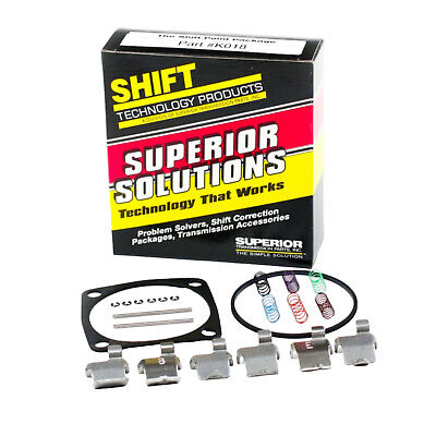

If I put the peddle to the floor it will change around 3500 -4000rpm 3 to OD but the lower gears change even earlier.
Will this shift kit do the trick?
ZZ4/700R4 and ford 9 inch with 3.50 gears.
You need to provide more information about your truck's set up as well as what has already been done to the governor, if anything. Is the engine stock or highly modified? Is this a daily/cruiser or do you have it set up for racing? Have you shimmed or blocked the TV limit valve in the valve body?
700R4s in stock daily driver trucks typically shift 1-2 at 10-15 mph @ around 2000-2500 rpm with moderate throttle...2-3 shift should occur around 25-30mph and 3-4 around 35-40mph with a stock, non-high performance governor. Do a line pressure test as well to see if your LP is excessive...
