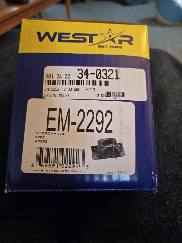

Need to replace motor mounts with motor in place what do in need to watch out for?do need to un do exhaust when lift motor

I've never thought about installing the through bolts first before. I can see where that could definitely help when installing some of the "less than perfect" mounts from the parts stores.
