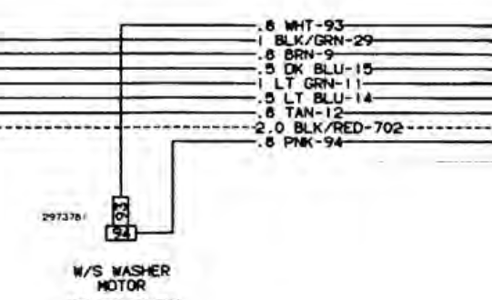

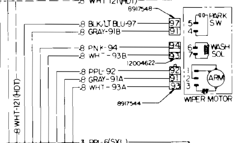

You should be able to- WHT 93 wire will brings 12 volts from the fuse box. PNK 94 goes back to the switch where it is grounded. Same wire setup on 85 & newer except the wires just goes to a separate pump (like the one in your link).
