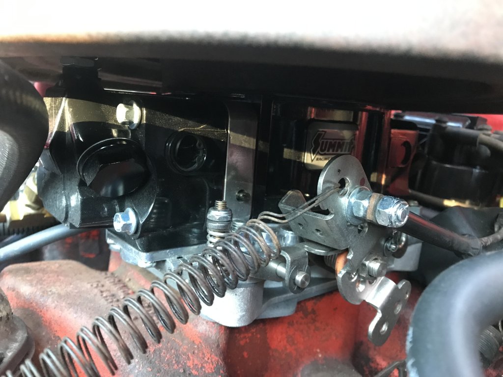

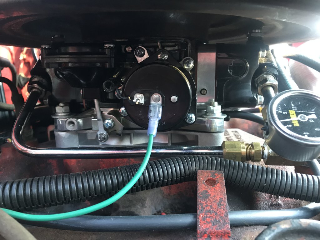

Been meaning to update this thread. I’ve been driving this truck now for a few hundred miles and it’s been running great. Starts right up and runs smooth down the road. Finally got it all dialed in and I’m happy with it…

That is the most unusual Quadrajet I have ever seen:hahano:

I was wondering how long until someone noticed. I just flat out ran out of time fiddle f@cking around with the old quadrabog. I literally couldn’t get it to even run around the yard after that first day of it running decently. Took it apart again, removed idle transfer tubes to find they were nice and clean anyway. Checked everything over again and still couldn’t get to run without mostly being choked etc etc. I had to move forward and I know Holleys so I got a summit knock off one and it’s great. Still need to dial it in but it runs great for what I need now. I boxed up the quadrajet and may try it again someday but not now I know that.
