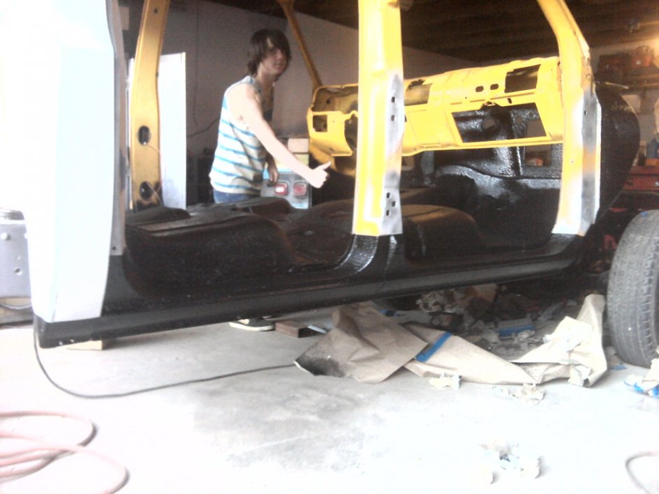

Looks nice! Has it been holding up well? I wish I could spray it, but no compressor and no spray gun. Can't afford to run out and buy a compressor right now either.
kleedus
Jan 25, 2012
1,726
162
wyo
Ray
1960 threw 91
c10 to k30
350 threw 454
the truck is still a project in the works and progress has been slow for awhile.
I have never driven it
just been collecting parts and money for it hopefully it will be the project in the garage this winter.
I sprayed the fiber board top to my tool box at the same time as I did the underbody. and it has held up awesome I toss tools on it and use it as a work bench. and it has not even chipped or anything yet. I also plan to use it in the bed as a bed liner when I get that far.
the under coat gun is cheap do you have any equipment rental places around you. might be able to rent a compressor cheap.
I am really happy with the way it sprayed I wouldn't roll it after seeing how well it sprayed.

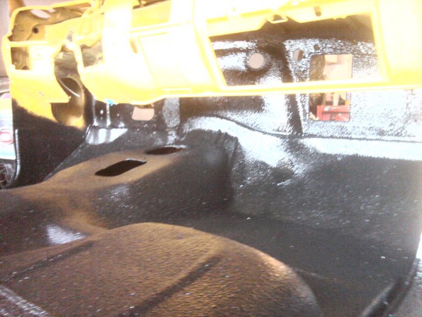

How well did the bed liner spray gun you bought work, and what kind of spray pattern does it shoot? Did you have to thin the bed liner or were you able to spray it straight out of the can?
kleedus
Jan 25, 2012
1,726
162
wyo
Ray
1960 threw 91
c10 to k30
350 threw 454
I did not thin it at all it looks a lot like rhino lining the texture it has
I played with the air pressure until I liked the way it sprayed
it was a undercoat gun I posted a link to the same type of gun in my previous post in this thread
its hard to explain the spray pattern it had

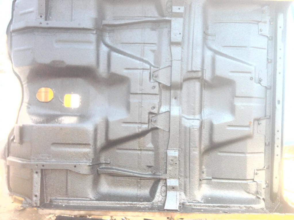

The silver chassis saver is very thin- kinda shocked at how runny it was. Now it needs to dry overnight then can put the bedliner on tomorrow morning.

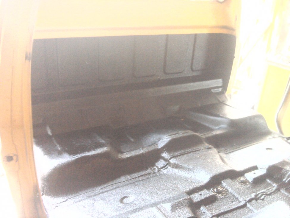

Got the truck done. Pretty happy with it. Should be very durable.

It has held up really well. Just like any sort of painting just make sure you prep the surface well first.
I've driven probably at least 2,000 miles on gravel roads with it and am often on overgrown roads. Trees can still scratch a bit- but is way more durable than paint.
