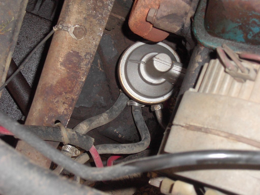

If that 2nd metal line ends very close to the fuel pump, then is probably the fuel return line. The picture I attached shows my three-port fuel pump and all the lines attached.
I would have to take a look at the vent line location in my truck, but I think it ends a different location that is closer to the passenger side. In my truck the vapor canister for the vent is on the passenger side, so that makes send. If you have dual tanks it's also easy to figure out which one is the vent line, since it has a T fitting so it connects to both tanks. It doesn't connect to the fuel switching solenoid. Also, if you have a fuel return line and two tanks, you should have a six port tank switching solenoid.
